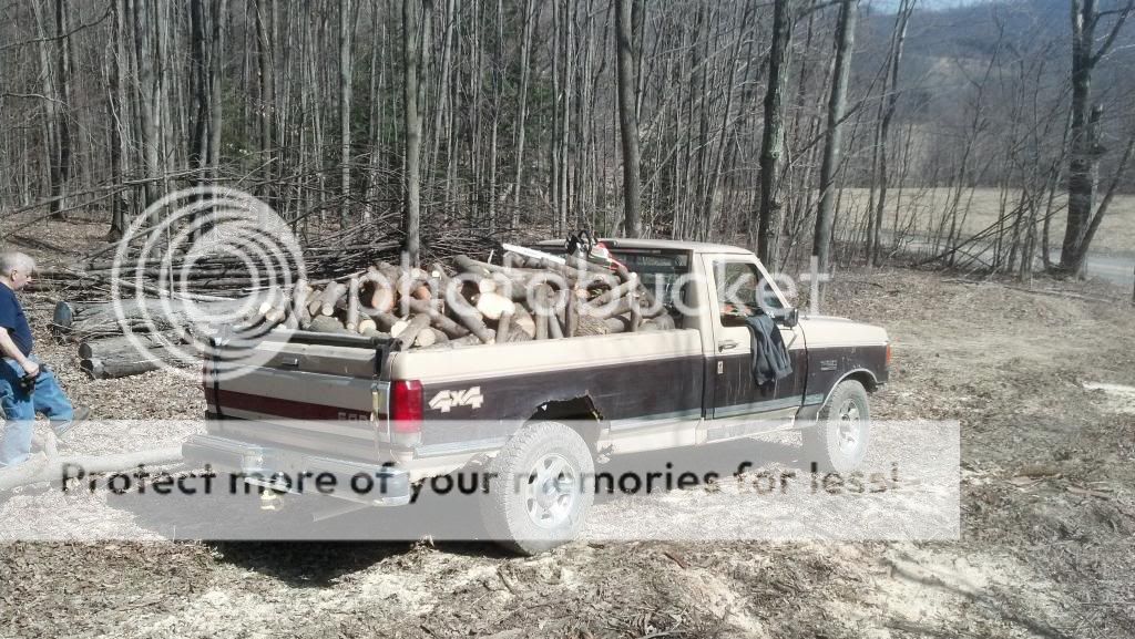

The truck is never on the street. It hauls logs, firewood and dead deer on my 58 acre property and surrounding properties. Just want something cheap. Now I'd like an Aussie on my ranger though. Looking for a rear locker for the ranger as we speak. The ranger is a 28 spline though.
