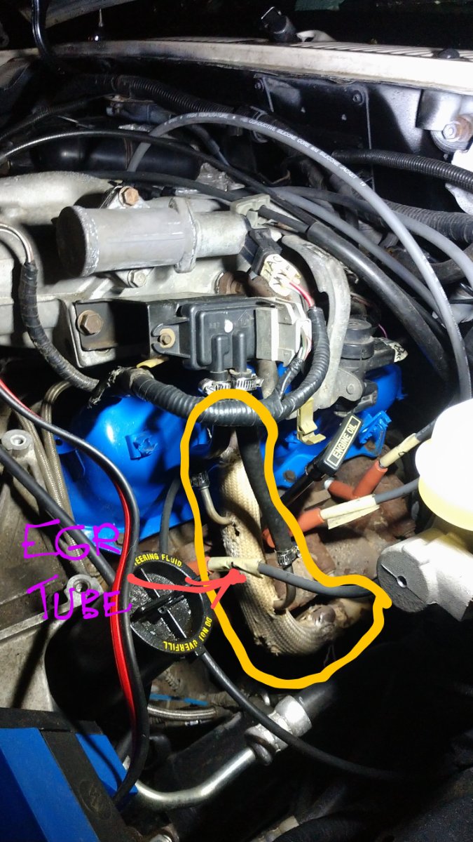

I’m working with the oldest guy in the shop but we can’t find a NGS diagnostic to see how the motor is actually working, he’s trying to find the books for the codes but we can’t find it, and the ford workshop manual doesent load up cuz the program they used is too old

The EEC IV diag manual wasn't online, it was a book about 4-5 inches thick for each model year.
177(M) Oxygen sensor not switching – system was rich Left or Front HO2S – Fuel control
Note that it says left. That's gonna be the driver's side.
Any time I have an O2 sensor code, I pull plugs first to make a slightly more educated guess as to how it's actually running. That color can tell you a whole lot.
Vacuum leaks, or leaking fuel pressure regulator can affect one side more than the other.

Thank you I ended up ordering 2 sensors for it as well I got new plugs for the truck
My Choptop was getting 12 mpg with a 4.0 being run on a 91 Ranger system. I finally bought a remanned computer for it (it’s a manual and I had been running it on an auto computer because I was having trouble finding the correct computer). Popped the cover off the old computer and found all three capacitors popped and took out a couple resistors. Put a new oxygen sensor in because it wasn’t that expensive. Runs better than it ever has now and my fuel economy has jumped significantly. I’m not sure what it is right now but I’m betting at least 15-18 mpg. Not bad for running on 35” tires
