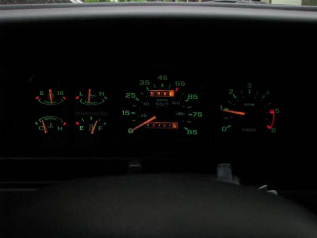

I got a gauge pod from a 93 Explorer today- Free
Thanks! Saved me $80 vs. buying an aftermarket tach and this looks much better to me anyway.
Cool, glad you're happy! Me and my dad did the same swap with a 2nd gen B2 cluster into his 2ng gen ranger and it worked seamlessly.
Well, with the tach in, I can see my highway RPM's-
2300 in OD at 60 MPH. Its nearer to 3000 at 60 in 4th, but the engine seems to be racing.
Is it possible I could get better mileage at 3k?
Who makes/where do I get underdrive pulleys for a 3.0?
I want to put a tach in my '92 Ranger....What year/model instrument cluster will fit? It's a direct swap, the tach signal is already in the instrument cluster wiring harness, right? Does the donor vehicle have to be a V6?

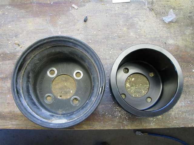

I ordered my pulleys from stuffforyourranger.com - Crank underdrive and alternator overdrive for $119 shipped. They have a "kit" with a belt and water pump pulley, but the belt can be had for less elsewhere and the water pump pulley is stock diameter, just aluminum. The loss in rotating mass on the water pump pulley is marginal, especially for the extra money.
The gauge clusters are mostly interchangeable, the plugs just snap right in, I believe all trucks were wired for all functions, regardless of what equipment went in them. Engine shouldn't make any difference.
My 90' Ranger had gages exactly the same as the ones I changed out on this 93. I don't know exactly what years interchange though.
Pulleys will be here tomorrow. :)

Pulleys in and installed. I can really feel a difference in the power- hope it translates to mileage.
