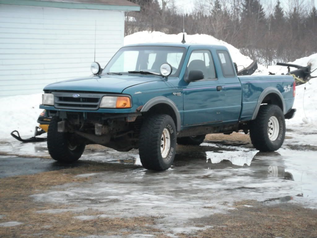

Going for the cosmetics now, sometime this week (hopefully) I'll be getting my truck decalled up a bit. Not that it doesn't look like a young kids truck already:D
your trucks little cousin finally grew up!
Bought time! Looks good Boggin:icon_thumby:
thanks bud. the wheels are on 1.5" spacers/bolt pattern adapters that i had come for the fx4 b2, but i figured id try em out on the ranger till i get the b2 lifted lol lol
Those rims must be pretty heavy on the backspacing then, my truck looks like that sans spacers. Of course it might be that the Eagle Alloys he bought are low backspacing because I think the stance it nailed on my truck.
