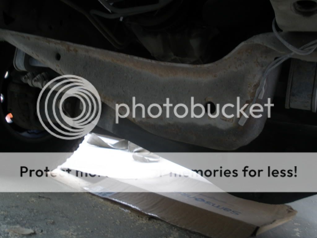

First off, WTF is this for? How strong is it, can it be a jacking point?

That "thing" in the first picture is just a crossmember with a weird shape to it. If you look closely, the shape has a purpose. Look where the rad drain petcock is... then look where the crossmember is. Then look at the shape of the crossmember...:icon_idea:
It's a crossmember that doubles as a coolant channel when draining your rad, so it all comes down in one area rather that spilling EVERYWHERE! Way to go Ford! :yahoo:
if you look even closer you will notice that right behind the deep part of that crossmember is the steering box and pitman arm.that is what it is there to protect.:icon_thumby:
