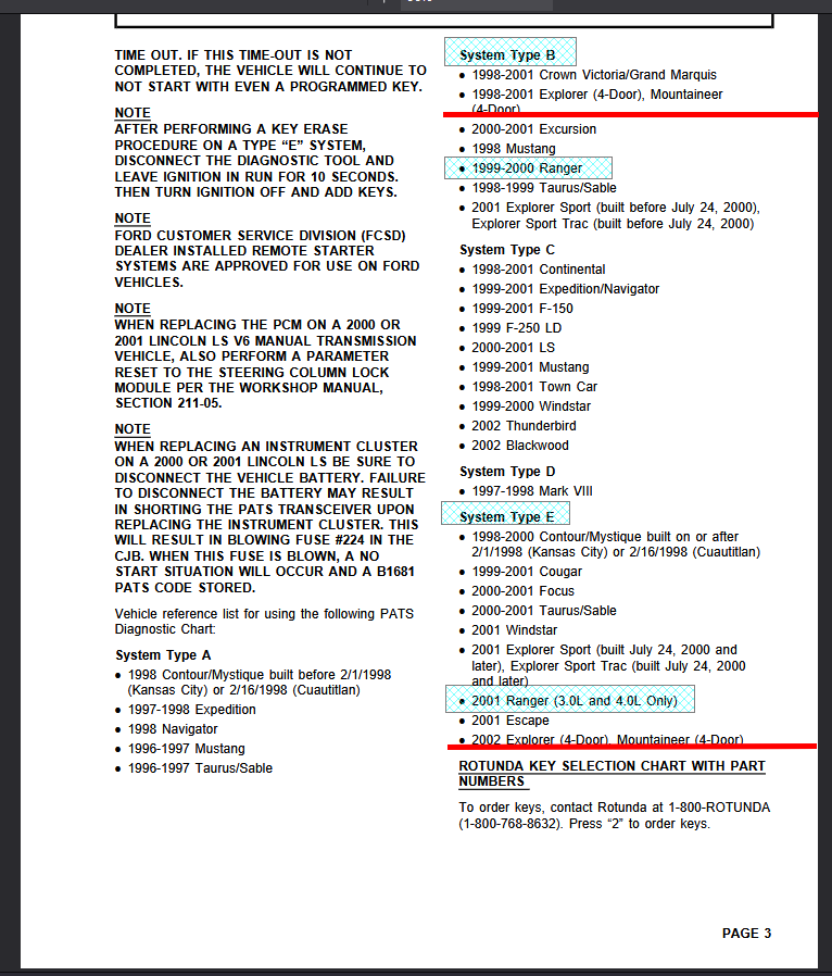

you didn't tell us the year of your mountaineer candidate.... and 2001/2002 they changed from system B to system E
As long as the recipient doesn't have it integrated in to the cluster I would think your plan would work... if it is past the detachable module and more integrated then more headache.
I seem to recall @corerftech converting his 2001 Explorer 5.0L V8 to carburetor, so I would assume that the Mountaineer is also 5.0L V8. To my knowledge they did not build any 2002 Explorers/Mountaineers with the 5.0L V8. 2001 was the last year for that, so they never got the E type PATS.
PATS aside, I think this would only have a real chance of working if the Mountaineer is a 99-01, and best likelyhood if it is a 2001. Ford liked to make running changes in the wiring harnesses. I don't think that there were any major changes for those three years. Earlier models, would likely have too many differences to work right.
