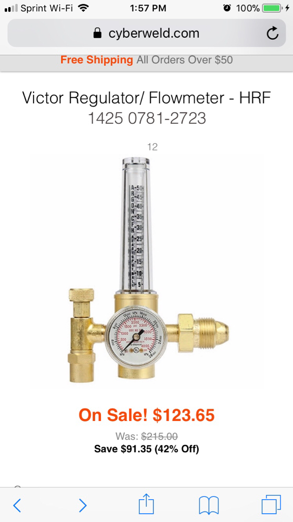

Thanks for the input, brotha. Looked up some Victor regs online for about 100 bucks. Sound about right? By any chance, do you know which model regulator you bought and where you got it? Much appreciated. :icon_welder:

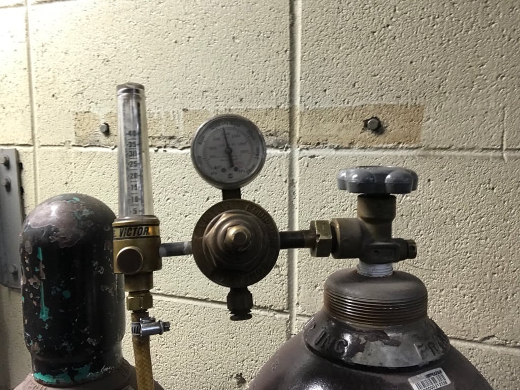

Unfortunately I’m not sure they make the exact regulators I’m using anymore which are 541I regs with flow meters on them.
Here’s the one I use at work for reference. Sorry the pic sucks a little.
I had one of these on my machine at home and we are replacing the old regulators at work with them. Also reliable as all heck as long as you don’t drop them (certain death for any regulator)
