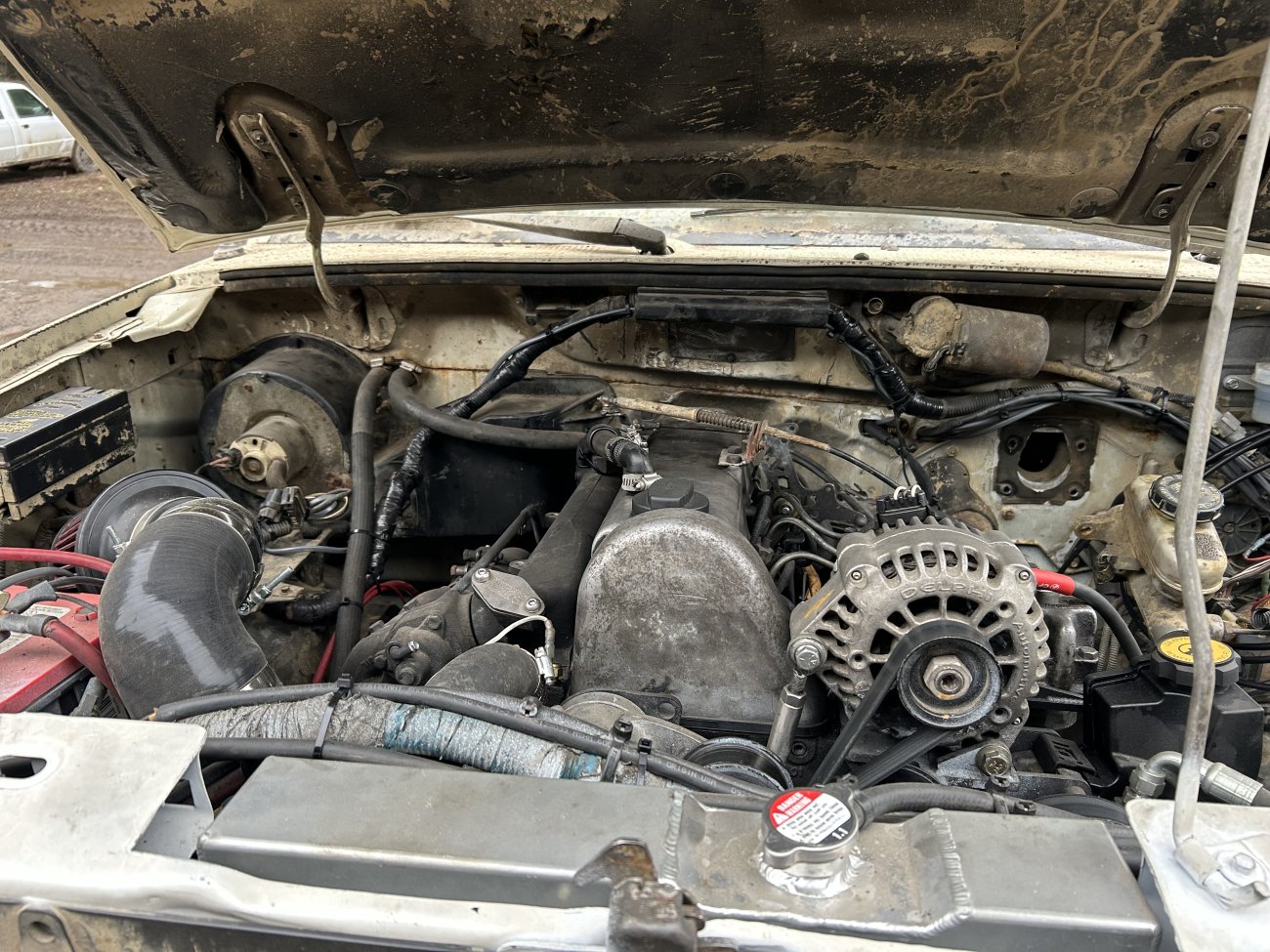

The truck currently sits in the shop getting a Mercedes OM606 swapped in to it. I am about to fab motor mounts in a bit here.
So far, among others, I have collected:
-OM606- from a 98 or 99 e300
-716.649 Transmission
-8mm pump (130-160cc)
-Holset HE250 turbo
-noname 2" Radiator for a Discovery or something
-NP205, Driver drop divorced input
-other upgrades
Im going to keep the pump turned down till i can figure out how to beef up the 8.8 or swap with something better.
Since the front of the thing is rusty, kinda mangled, and from a 2006 front clip after the mexico crash I decided to delete it and fab up some tube frame action to support the radiator and other bits. Ill post itt once i get more work done.

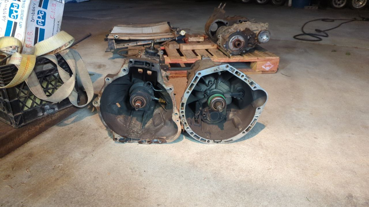

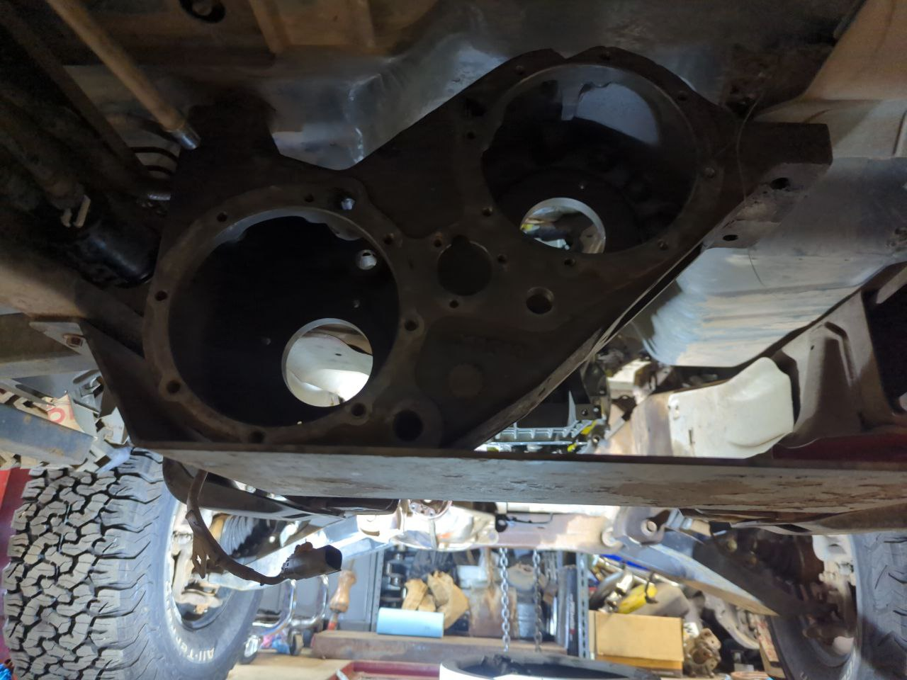

For reference, or in case someone else is dumb enough ambitious enough, these are some size comparisons that I wish i had before i started.
BW 1353 vs NP205 (I took the case after i ripped the 205 apart to refurb it, ill post later with complete assemblies next to each other)
Mercedes OM606, NP205, 716.649, 2011 Ranger
M5R1 trans next to Mercedes 716.649

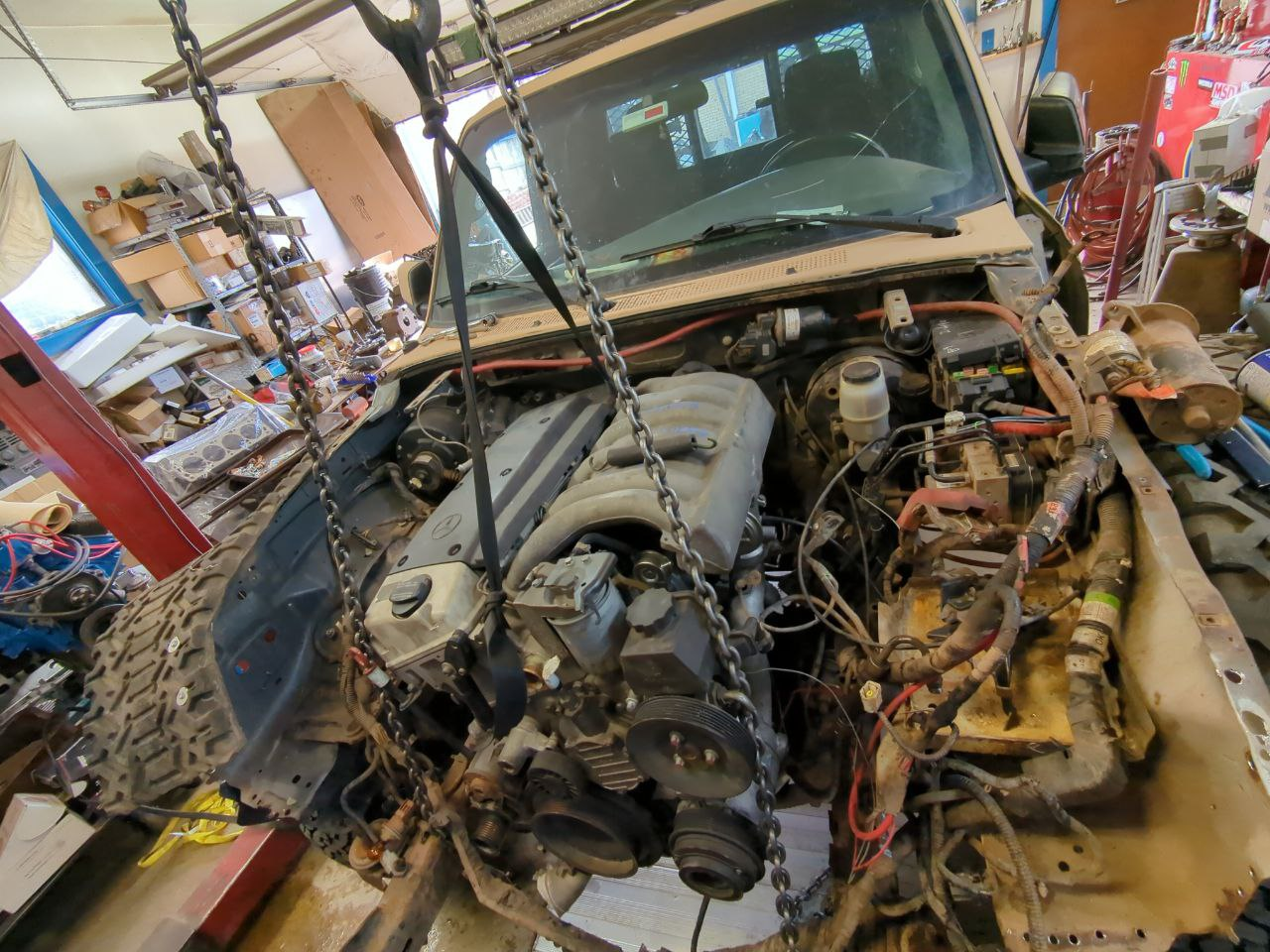

Deleted rad support, with engine elevated

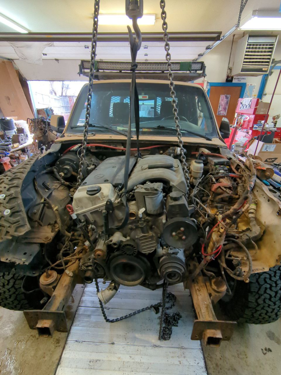

OM606 suspended in engine bay
Engine is rotated clockwise due to lifting points. From a basic fitment standpoint, i *think* i can use the existing frame mounts, with a plate or perhaps a whole new motor mount. Not sure, I still have a bunch of work to do on the frame before I am ready to start mounting it in the rest of the way plus some stuff to do to the motor. It looks like it will fit ok.
If anyone has any suggestions on the mount, I would love to hear it.
Ultimately, I will have to either adapt or fab a yoke to go on the back of the trans to connect to the divorced tcase. Of course, will need custom drive shafts. If anyone knows how to beef up the dana 35sla, I am all ears because i am going to detonate it the second i put power on it.
I have a theory, where as long as I leave it in 2hi or 2lo i will be ok. I want to examine putting a vac solenoid on the boost signal line to the pump that shuts it off into what I call "children's mode," forcing the pump to stay in a pre-boost fueling status that will keep it at lower numbers for when I have to actually use 4x4 to get out of a silt bed or up a hill slowly.
Truth is, i have no idea what I am doing or what I am talking about.

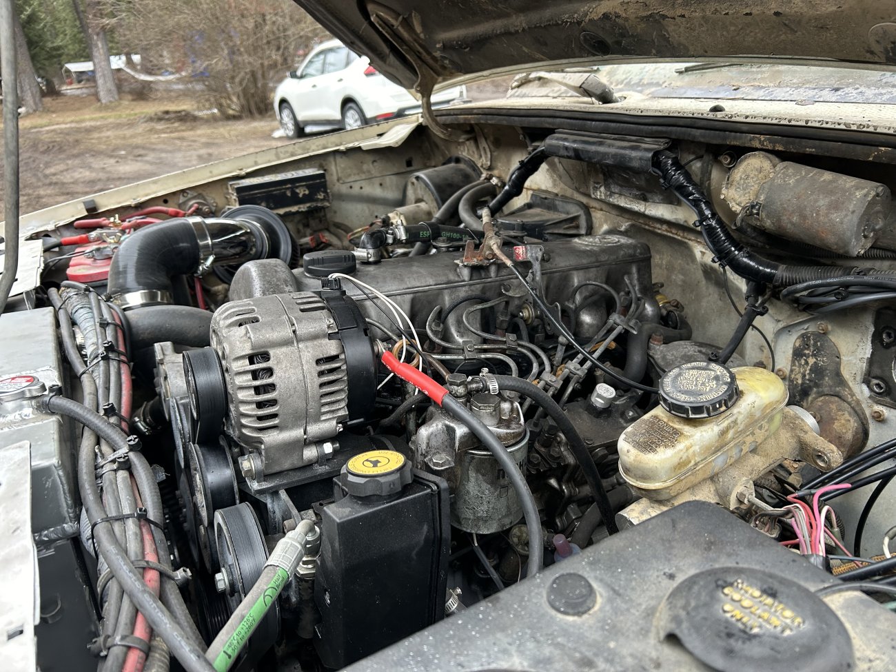

Well I’m glad you’re starting with a better engine than I did. I swapped a OM617 in my B2 and hated it from day one. At leas The OM606 has some power. But man the om617 was hard to fit, I couldn’t imagine what a 606 would be like with another cylinder on it….looks like an awesome project! Will be watching!

Yeah it wouldn't fit easily at all if i didn't delete the radiator support. I found out tonight that I need a rear sump pan, since I am running 4wd. If someone wanted to do a 2wd version, they would likely get away with the front sump but it would be tiiiiiight.

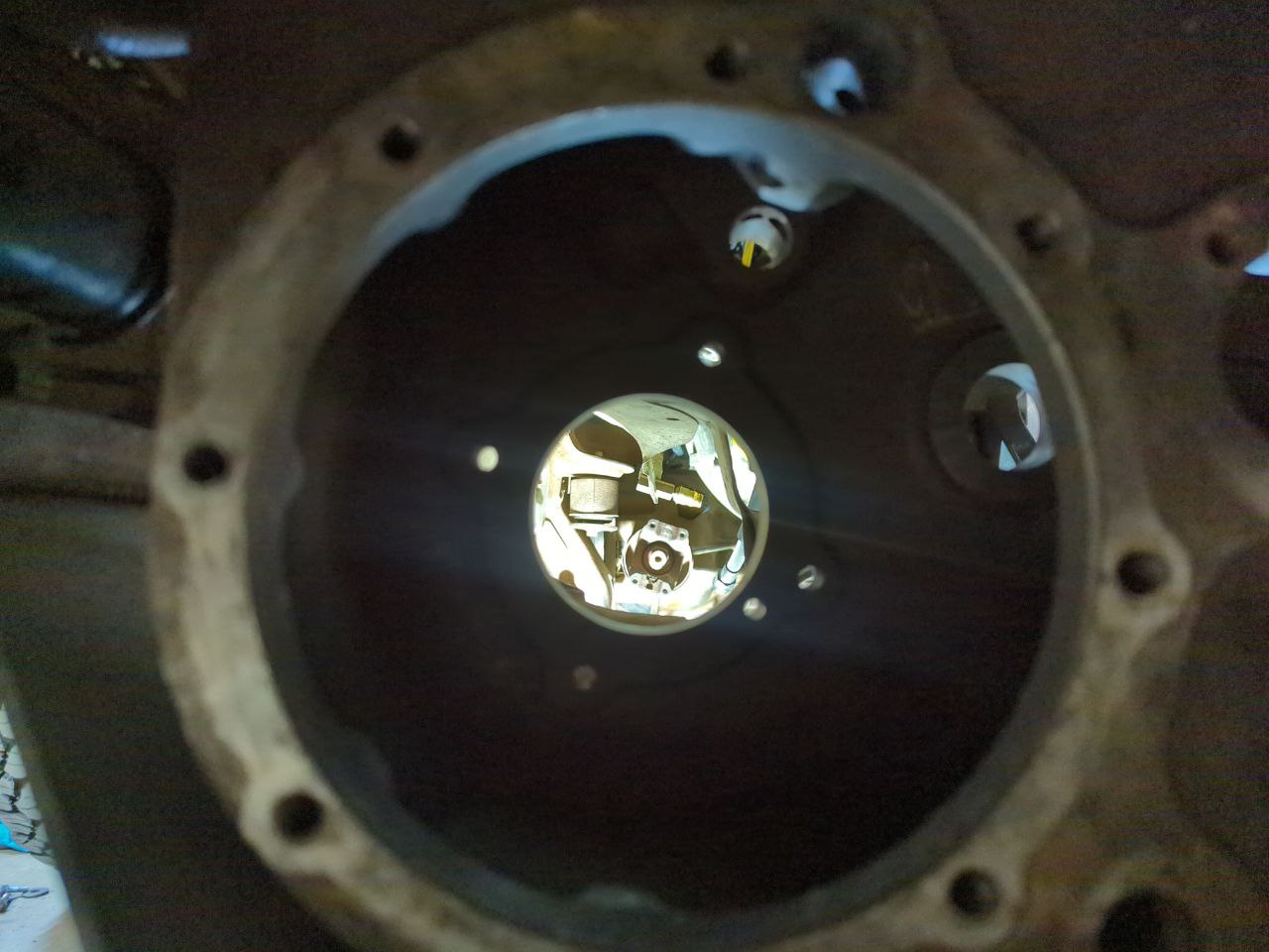

Transmission output

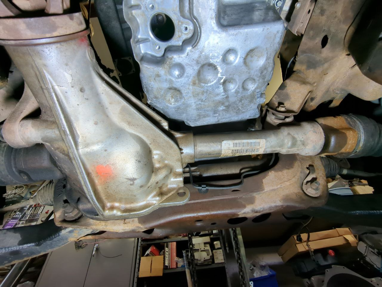

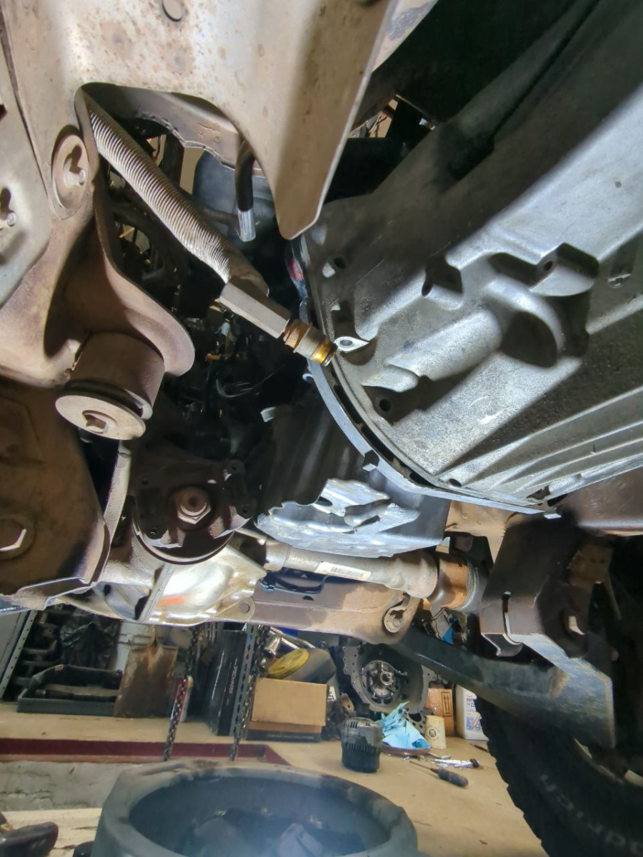

About ready to start fabbing mounts. Swapped the 606 front sump pan with a rear sump and oil pump, should have taken some before pics but I got exited and also oily.
This is the rear pickup sump pump. Front sump pump bolts were a little bit too long, so mr grinder came to the rescue. Cut about a 1/4" off the bolts and they fit fine.

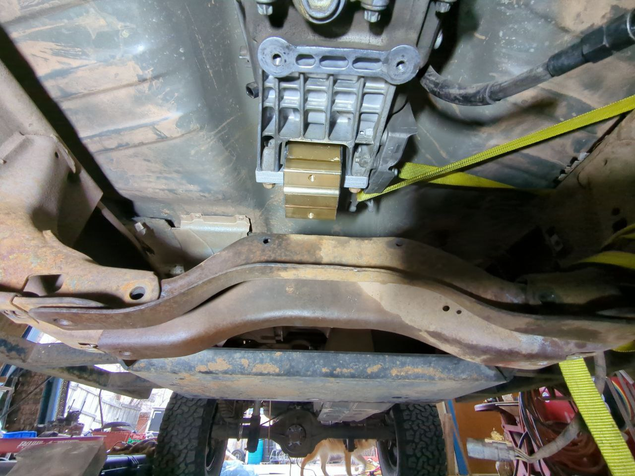

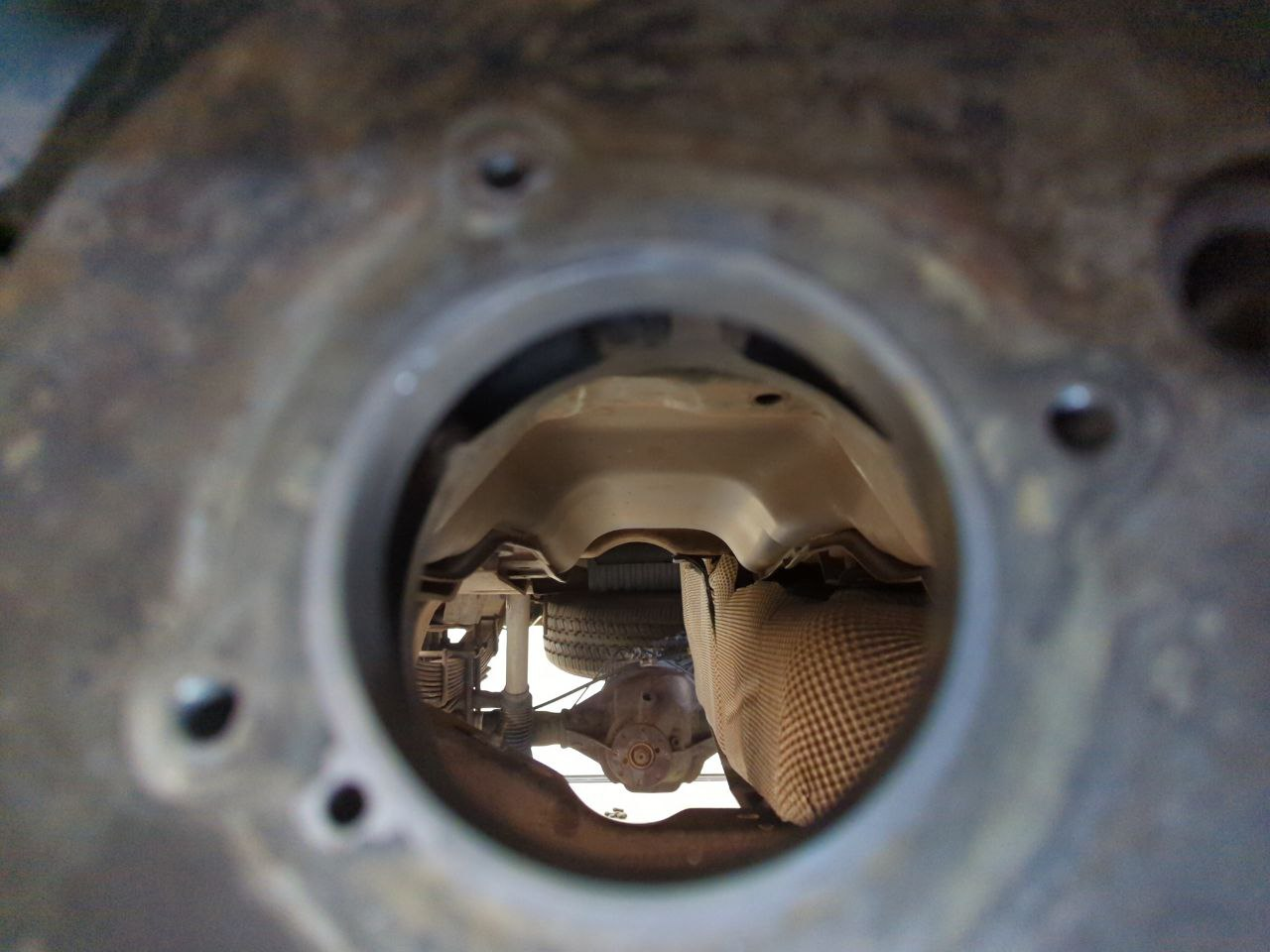

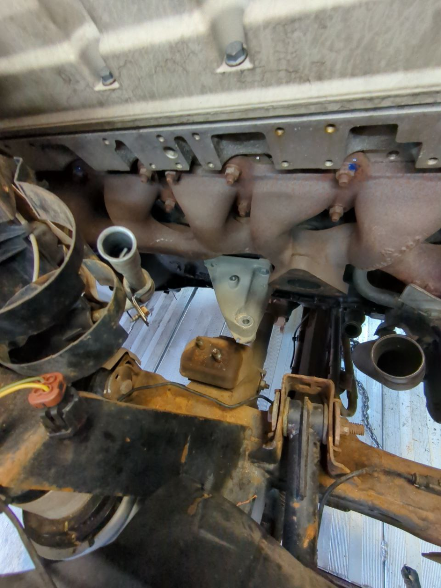

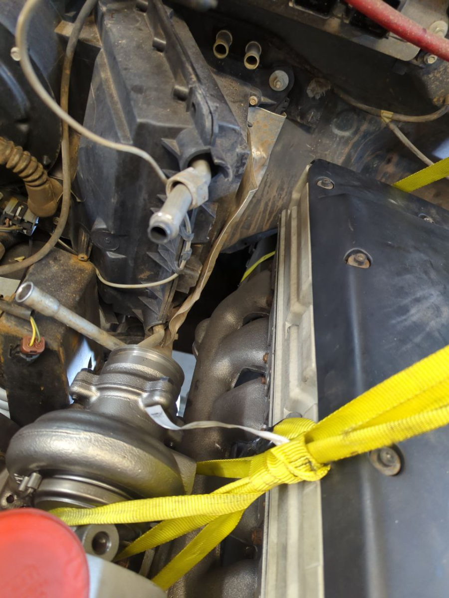

Here is some clearance pics as its dangling on the crane, no mounts yet. Looking rearward, front diff in frame.
The pan bolts do not connect to the trans. Not sure if this will be an issue later down the road or not. Might be able to drill if i feel inclined.

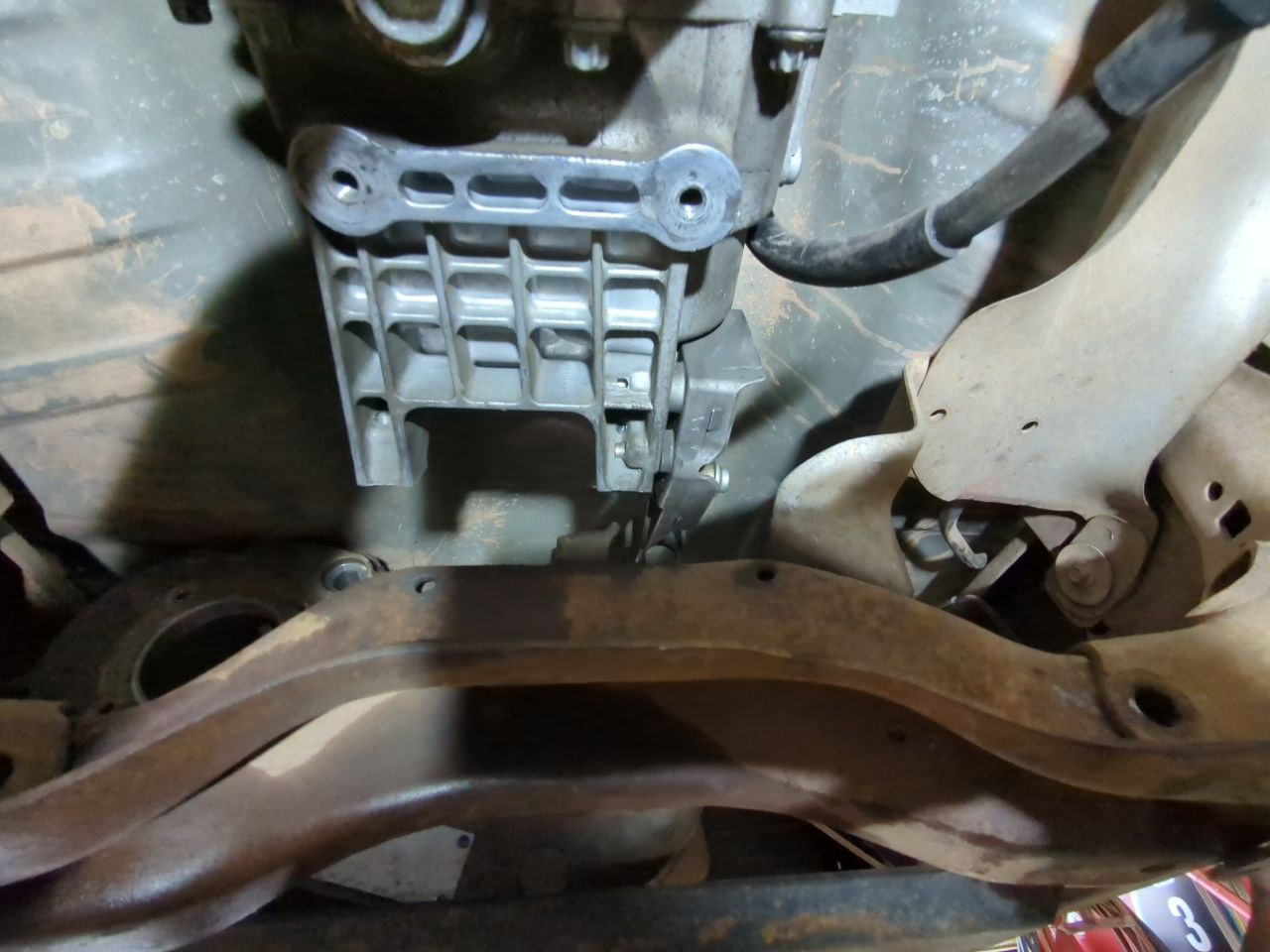

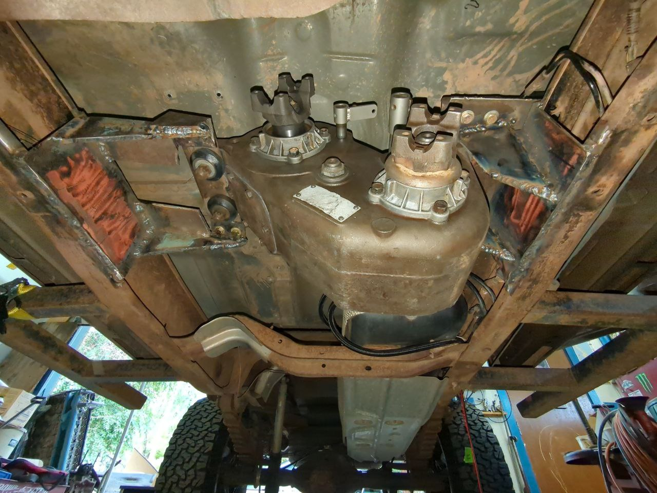

The stock tcase bracket looks like with a plate it will be able to attach to the rear of the trans.

Ended up cutting the oil pan to get it to fit properly, due to the insane tight clearance around the front diff. Also started ripping out the interior, getting ready to put in some gauges and such.

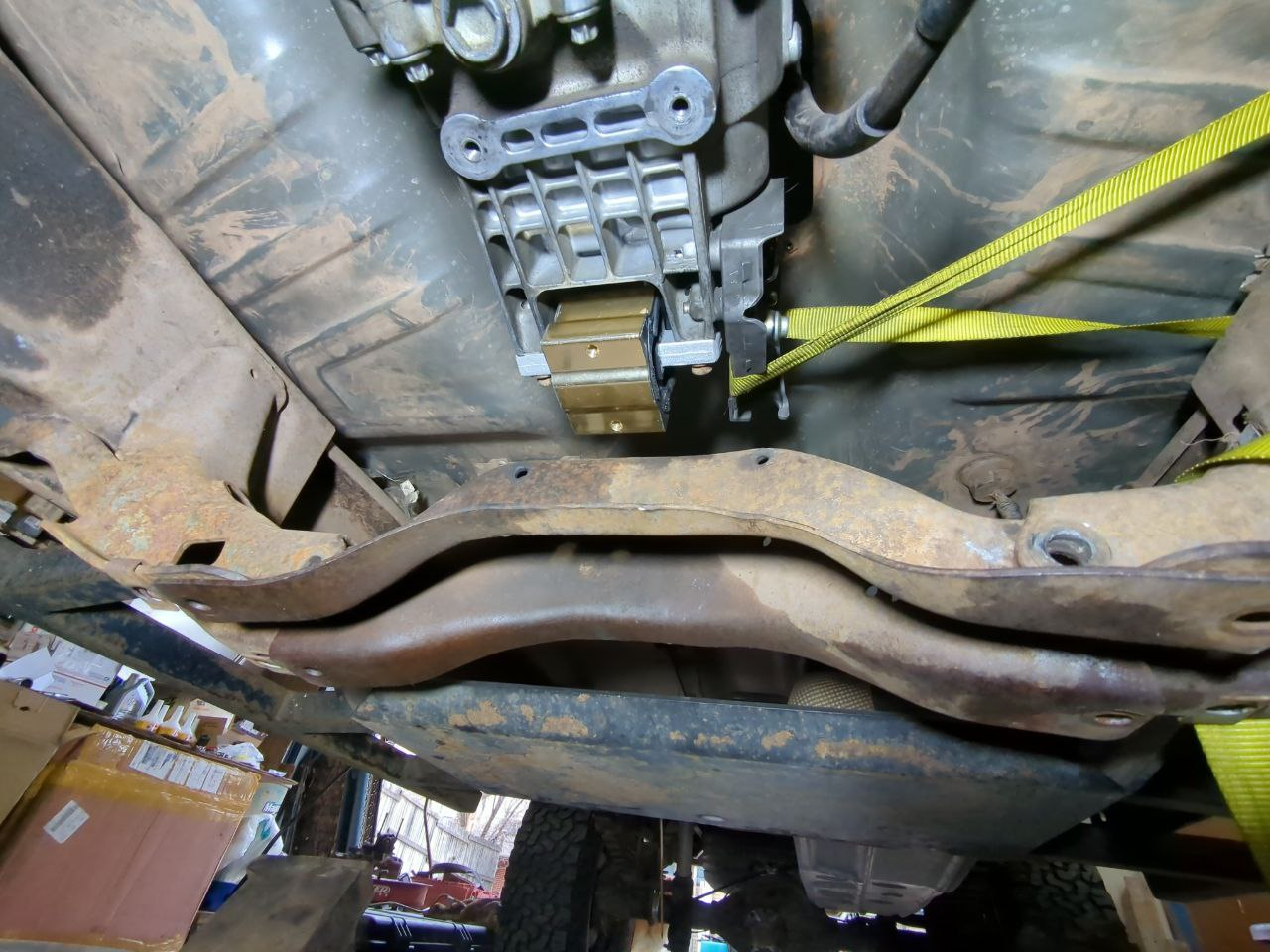

Transmission with a factory mercedes mount. Will be using the existing crossmember with a plate to grab the back of the trans, maybe a cross bar or something to support it further.

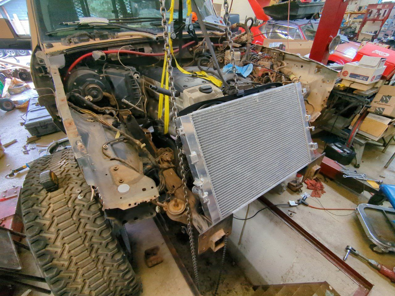

Got a radiator for a discovery. It will match almost perfect to a ford fusion fan, in case you were wondering. Some fella on the land rover forums mentioned this.

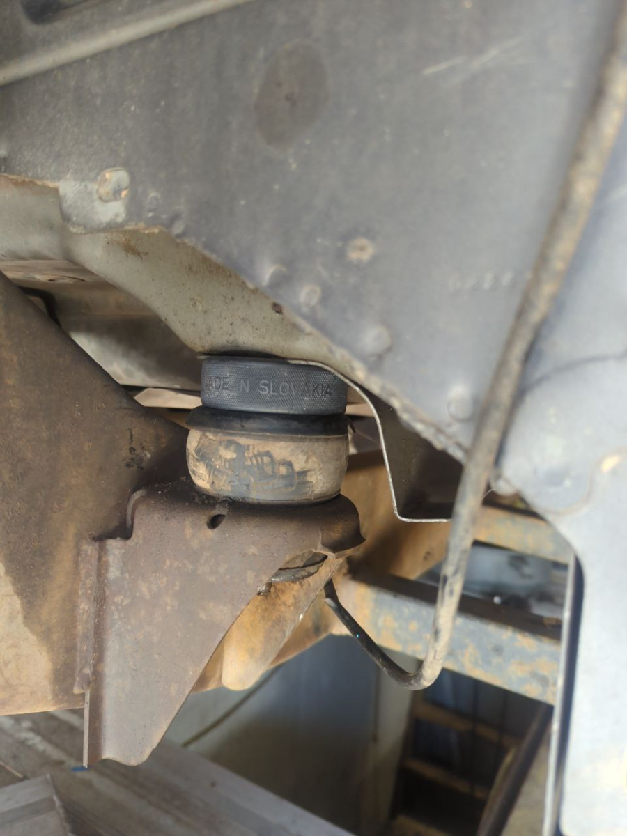

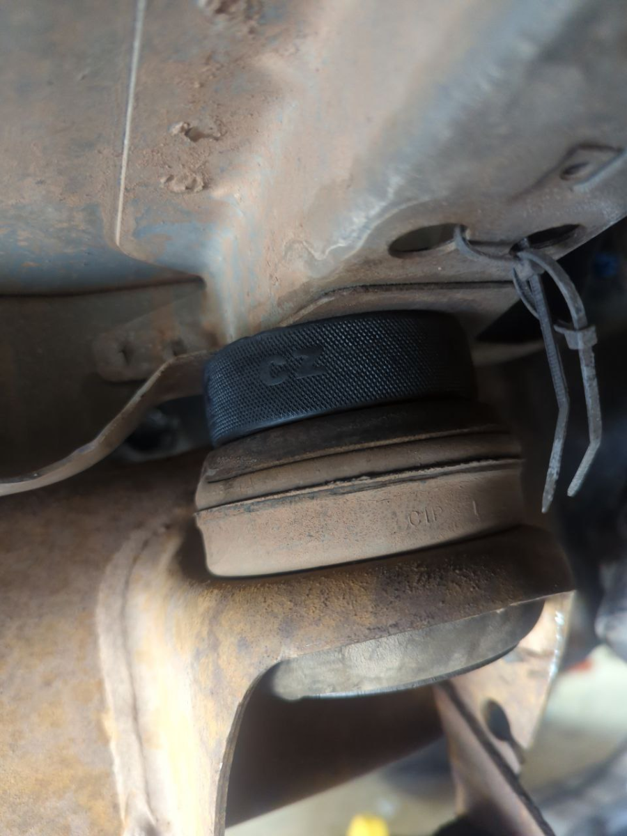

Also did a body lift with hockey pucks. Drilled a hole in the pucks and used the stock bolts... probably should get longer ones. It seemed to grip well enough.
If it doesn't have a body lift, I would add maybe a 2" minimum lift. Will help a lot with room for the T-case and maybe a little more clearance for exhaust past the AC box
Ended up doing a 1" with hockey pucks, because that was all i could fit with the roof rack. But your post made me do it
nice! Yeah little bit of a body lift fixes a lot of things. More tire clearance, can access transmission bellhousing bolts.
