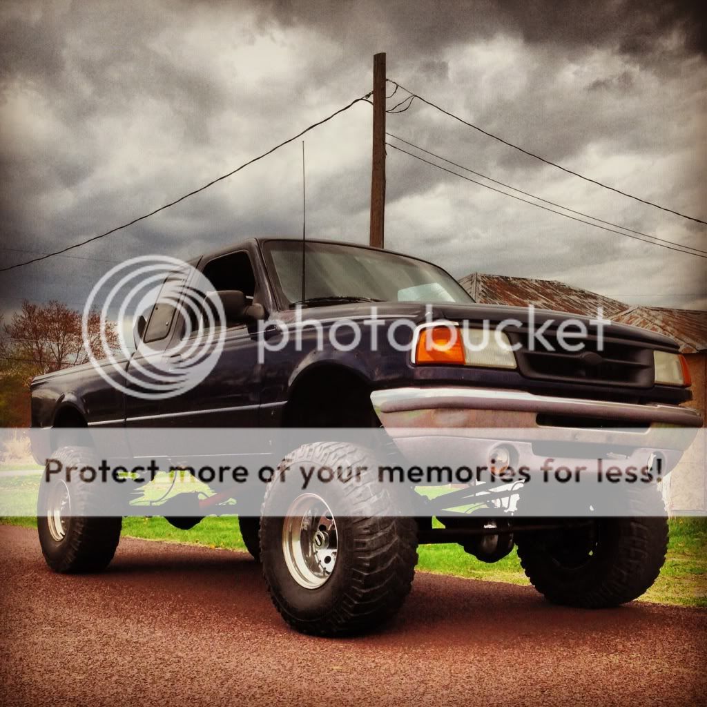

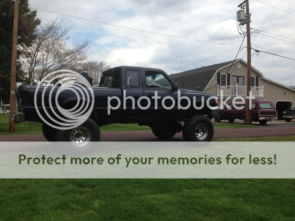

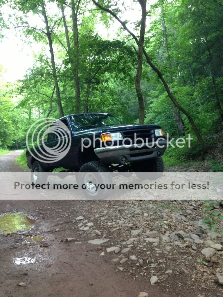

the only progress that i have done is installed 78' f150 coil buckets with 79' f250 shock towers, 6in skyjacker coils. i was fooling around with her on holiday leave and the transfer case decided to crack. So when i get back home in may ill be swapping in a manual t-case with many other modifications and pictures!

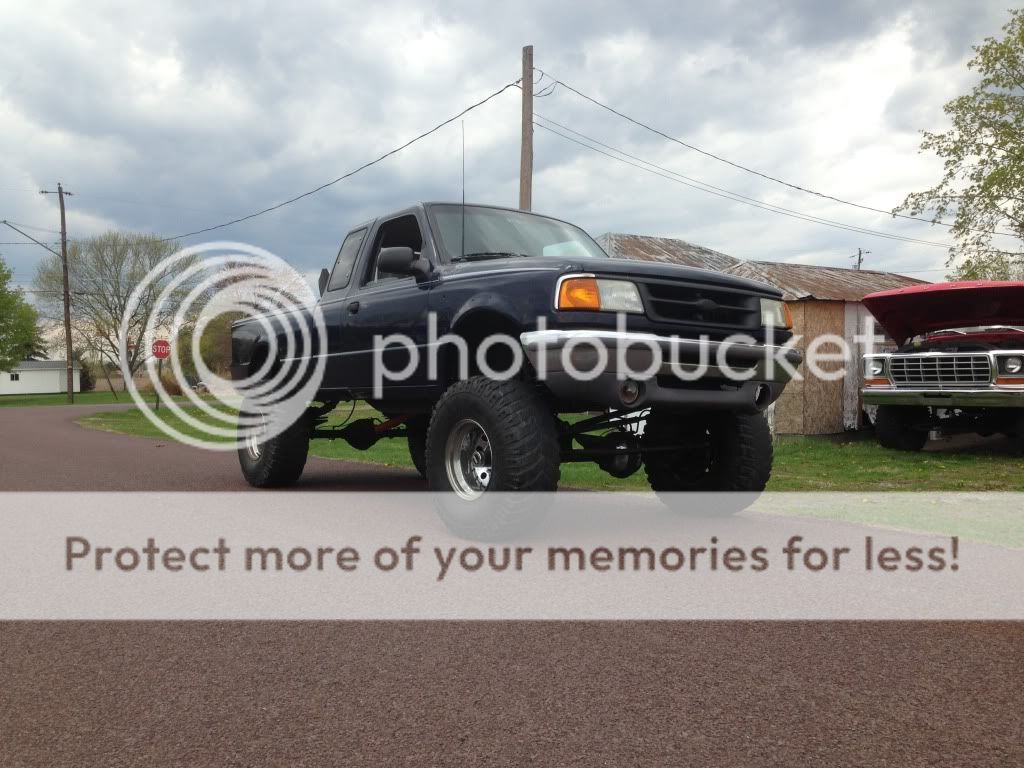

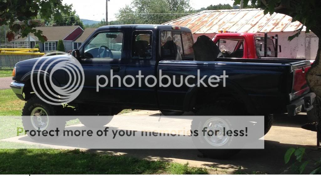

meatballs 95 straight axle build! parked at my buddies buisness, his f350 8in lift 36's meatballs 95 straight axle build!

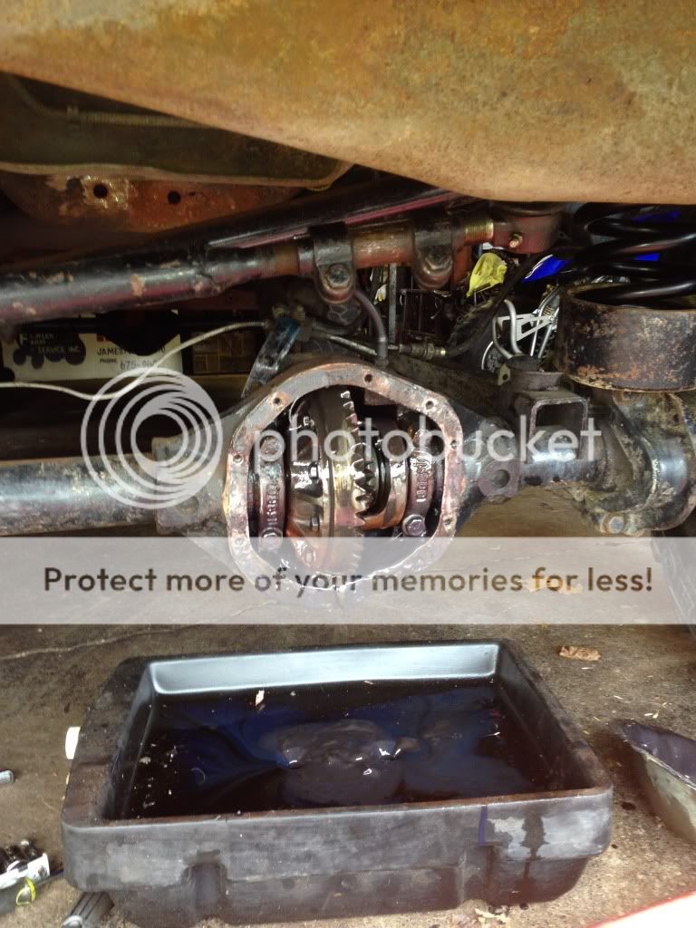

I pulled the 5.13 locked gears out and installed the 4.55 locked ill see how these work on the rocks. Also I replaced every fuel line and fitting, And finished the brakes. So far I have the entire brake system replaced and the fuel system.

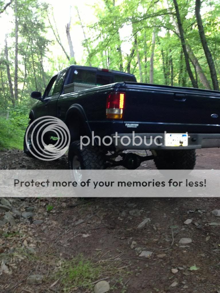

I have put my ranger on the back burner while finishing my F150 and getting her road worthy. I have to leave again, Headed back to base. But ill be home in a few months to finish the ranger. meatballs 95 straight axle build!
