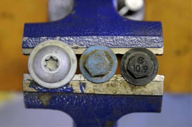

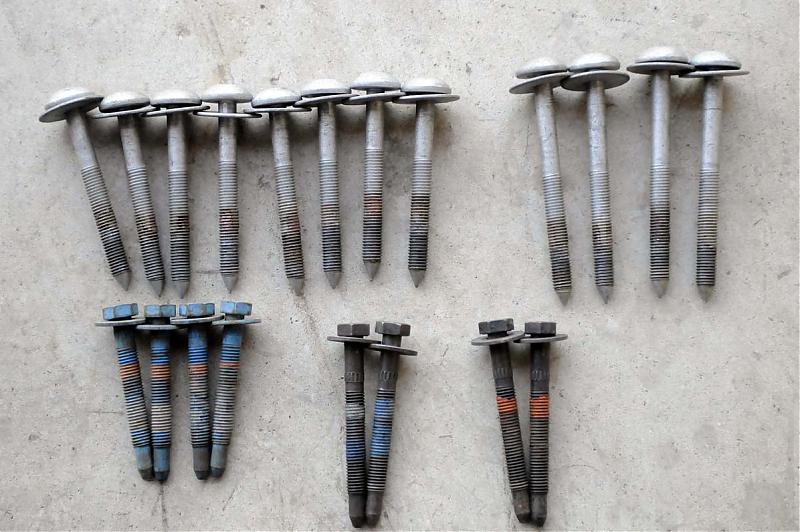

Got all the body lift bolts loosened. These are the factory bolts that i took out when i put the body lift in. Anyone know which ones are for the cab??

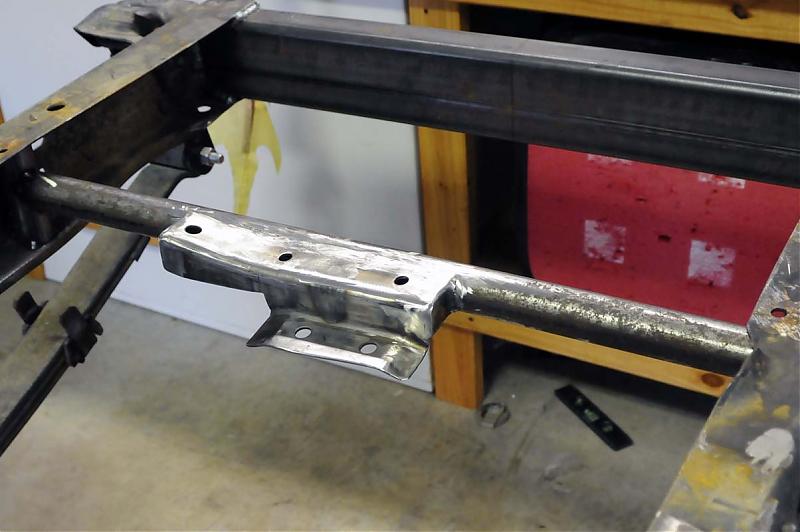

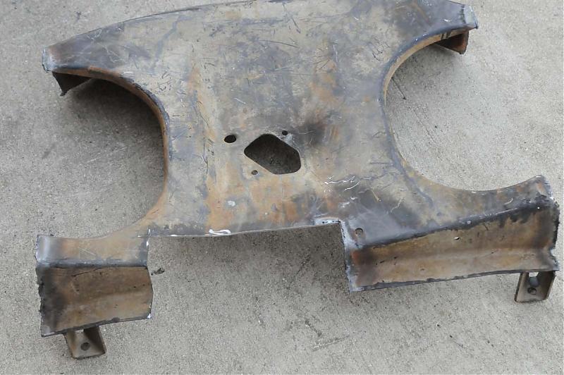

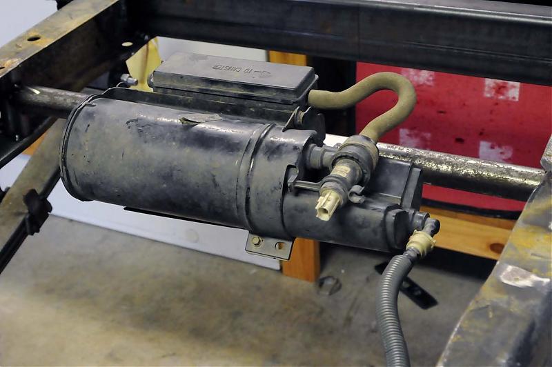

Cut out old spare tire carrier and cut part of the canister mount off and welded it to some 1.5 tubing to integrate into the rear bumper.
You sure got alot of bed bolts. lol.
TOP ROW, LEFT SET: Rear 4 bed bolts
TOP ROW, RIGHT SET: Front 2 bed bolts
BOTTOM ROW, LEFT SET: Front Cab Inside Bolts and possibly Front Radiator Support Bolts.
BOTTOM ROW, RIGHT SET: Rear Cab Inside Bolts and possibly Front Radiator Support Bolts.
Dont know if you've solved this issue yet, but i'd figure i'd help. I dont remember exactly what the Core support bolts are...but I have a STRONG feeling it's the Bottom Row, Right Set.
Thanks for the help fx4wannabe01. I dont know how i ended up with so many damn bolts. This thing has been sittin for so long i got parts all over the place. I had to torch out the isolator bushing under the front mount cause the body bolt was bent. Cost about 50 bucks to replace. I really wish i had never put that body lift in, it has caused more problems for me than not.
