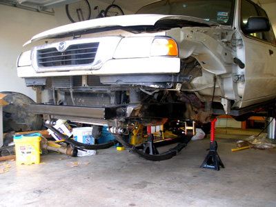

Still no new progress as of late. Ran outta cash:dunno: Got some guy coming today to buy old upper and lower arms. Next purchase gots to be a new angle grinder and spring perches for the D44.
I cut off the front factory cross member on the front of the frame. Just gotta try and motivate to weld on the new one.

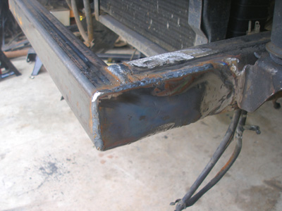

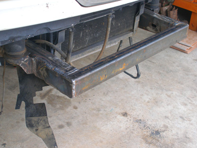

Ive really been slacking lately. Last week i welded a peice of 3/16 2x4 as the new front bumper. Its got 3/16 fishplate to add some strength. It will be a nice stout mounting place for a stinger. Hopefully i can light a fire under my a$$ and mount the spring perches next week.

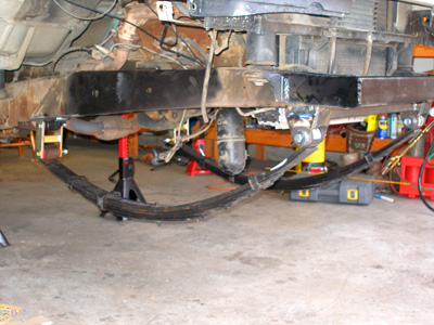

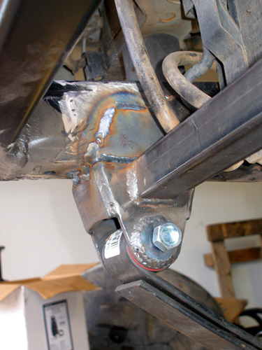

Finally got the springs on. I just needed a little motivation. Went pretty quick and easy. Still i have to mock up the axle to weld in the shackle hangers though. I bought this spring hanger from trail gear to save myself some fab since i gotta watch my kids all week and can only work on the weekends. The bolt holes were 3/4in and my 44044s take a 1/2 bolt so i had a freind machine some steps,that i welded in the holes. I used the gussets that the spring hanger came with and welded them on the inside of the frame for added strength.

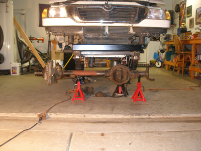

got my front spring perches from RuffStuff. gotta grind down the drivers side to fit on the pumpkin.
in the mean time, i just put the axle near where it will sit.

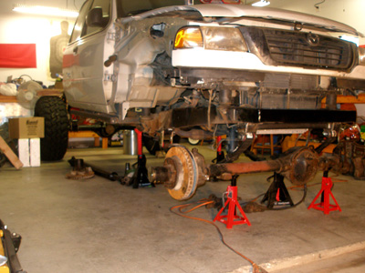

So i was looking at my axle in relationship to the springs today and noticed that they are not centered. Somewhere along the way i forgot that the axle center of spring pad to center of spring pad is 32in. I somehow welded my spring hanger at 28.5in center of spring pad to same. now the pass side is 3.5 in longer than the driver side. Measure 5 times and cut/weld once.....sober. Thats gotta be my new rule.
If you look at the pic above you can see where the stock spring pad is to the left of where my spring is.:bad:
So now i get to cut it all out just to re-weld it.
