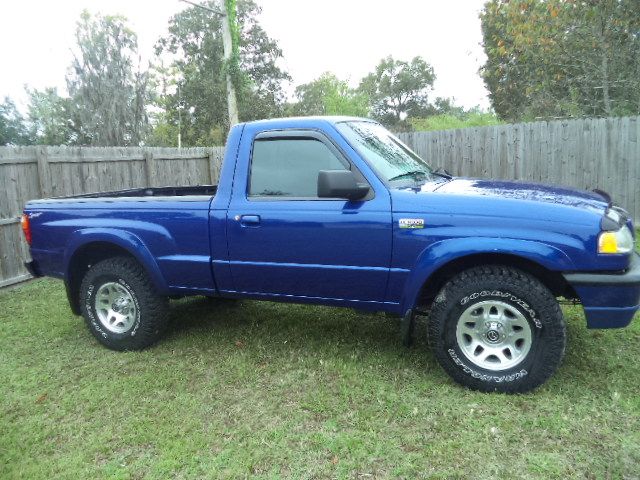

Been going back and forth deciding- i wont be lifting or offroading- i like the fact the 31's will give a very slight lift by itself - my truck is an 06 b3000 dual sport 2wd stock 4.10 gears 235/75/15 wrangler rts from factory and was happy with the ride and replaced tires and bought the rts's again. Time for tires again and i want to go to 31x10.5x15's- been looking at the wrangler authorties- no interest in the bfgs but fearfull of a few things as far as the 2 size upgrade and the type of tire im looking at .
im getting 20mpg and this has not changed since new. - how much will i be loosing in mpg
how is the ride ? ive heard excellent to wobble at intersate speeds- we have 70mph speed limits
dont care about noise - just dont want a sloppy death wobble or shimmy
my truck in pic &im using the stock rims shown - just never saw another b series owner with 31's to ask .
i also do haul the occasional motorcycle - had a 1400 intruder and 600 shadow in bed at same time last week . dont want any issues of rub or scary ride with 900+ lbs in bed.
so 235's again or 31's ????

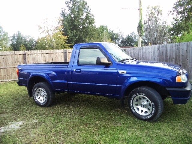

Actually got my new 31's this morning. I went with 31x10.5x15 wrangler authority's
very happy so far
should i stick with stock air pressure or bump it up a bit
factory is like 30fr 35 rear for the 235's
mazda bseries go to 31's?
Looks good. A subtle difference.
32psi front and between 26psi and 28psi for the rear. If you drive around unloaded 26psi is what youll want to get even tire wear. Anything over that and youll just wear out the center tread on those rear tires.
