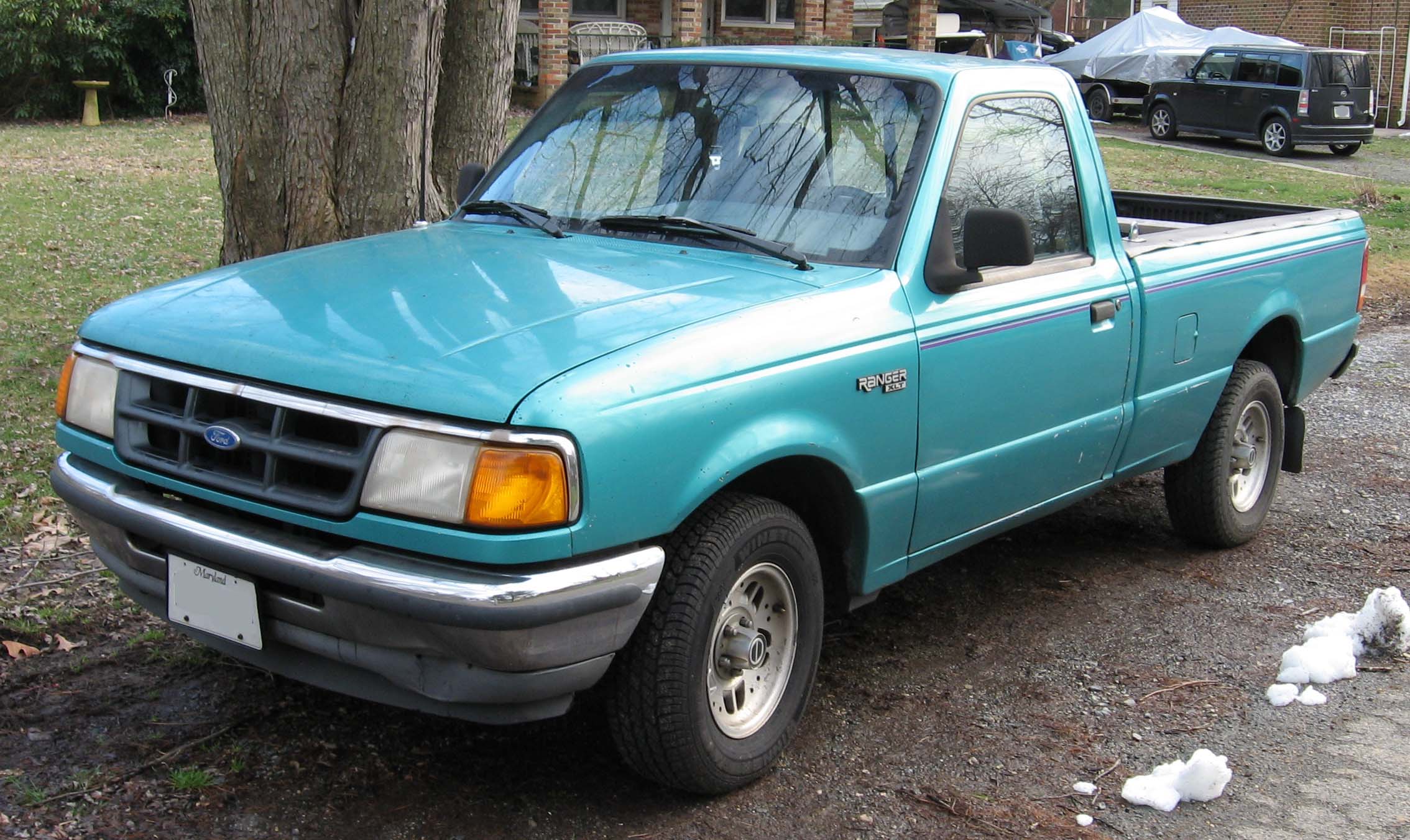

the cab back is the same as a 93-97 ranger including the core support, so the 93-97 fenders will bolt on and the lines will match, just match frontend to fenders, worse case you gotta change the radiator support(which i doubt), if you do change the radiator support install a 98+ one and drill 2 holes for body mounts and you can convert your mazda to something like this(98+ ranger)

EDIT: Actually I just googled it and the lights are completely different and they wouldn't fit, oh well I was more concerned with the lines if I switched front ends.
As you can see in the above picture, the fenders are completely different in the headlight area.
I put a '97 Mazda cab on a '94 Ranger chassis, the firewall was completly different. I ended up using the Ranger firewall on the mazda cab. Every piece of the front end is different but, The body lines do match. The front clip from the Ranger bolted on the Mazda cab. You now can't tell the cab was ever changed.
