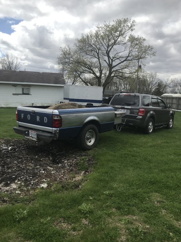

I got a load of dirt in my ranger trailer that was near quite a bit, not weighed though. Towed it about 7 miles with no issues. (with the escape)

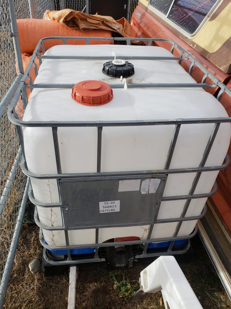

This pic is what I expect you would use. I think it's about 250 gallons. Make sure its tied down very good. I would use at minimum 4 x 1200# ratchet straps.
