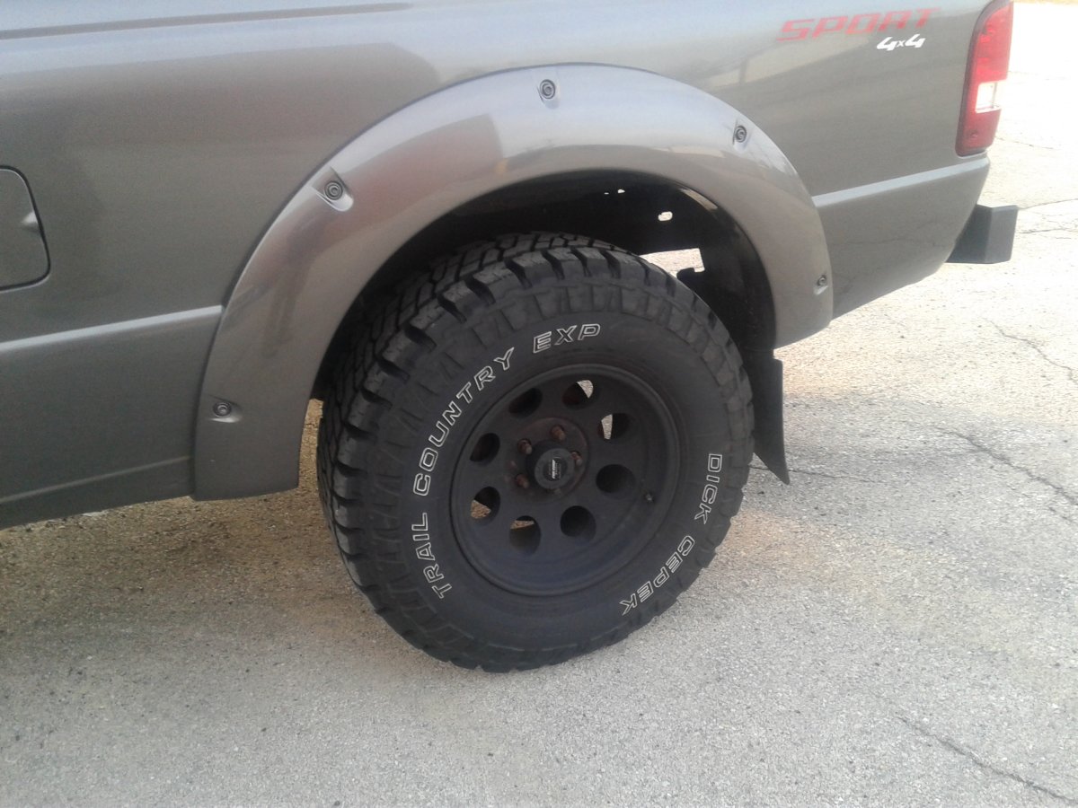

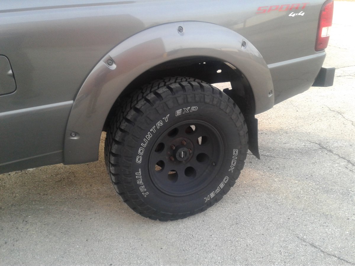

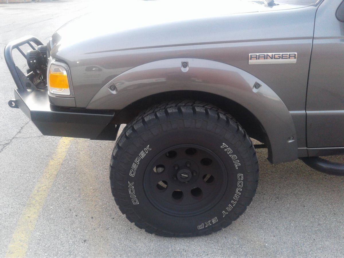

On my truck... I run 265/75/16's on 16x8 inch wheels with 4 inch backspace at factory ride height with no rub.

View attachment 83787View attachment 83788
