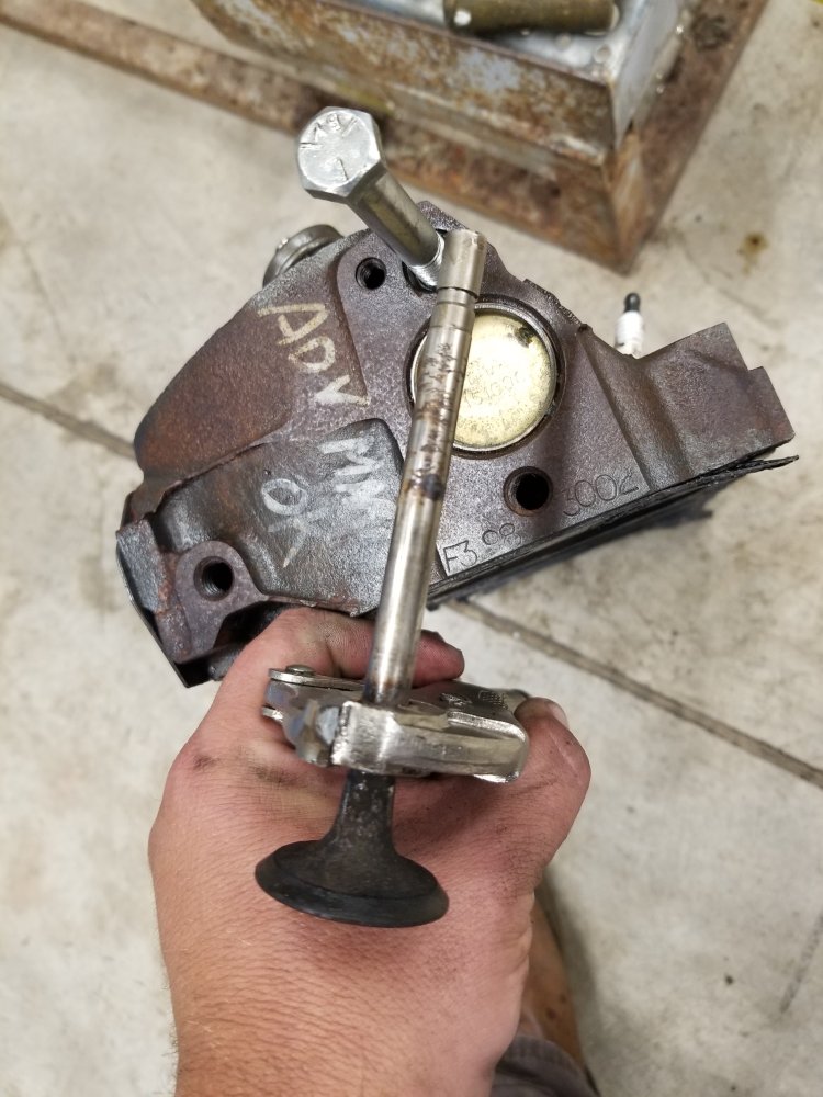

Ok, got the valve out, it didn't wanna... turns out the valve stem was rusted, I'll try to post pics later... so I need a new valve for sure, I'm pretty sure most issues I've been blaming on carburetors have been this since I got the boat...
Ok, I noticed something tonight... I think there are thermactor ports in the head, looks like oddly in this cylinder and for whatever reason exhaust runs under the intake manifold plenum... I noticed that the wire harness plastic loom was melted on the center two intake manifold bolt heads on the side with the issue and staring at it and the intake gaskets it looks like it has been leaking around the dang port! So with that said and the fact the boat sat uncovered during rain for a while outside with a wood engine box what do you think the chance that water could have made it through the intake gasket and under that valve?
I have a feeling that I've been fighting it for a while but still think this might be plausible, it sat outside with the mooring cover for the previous owner too...

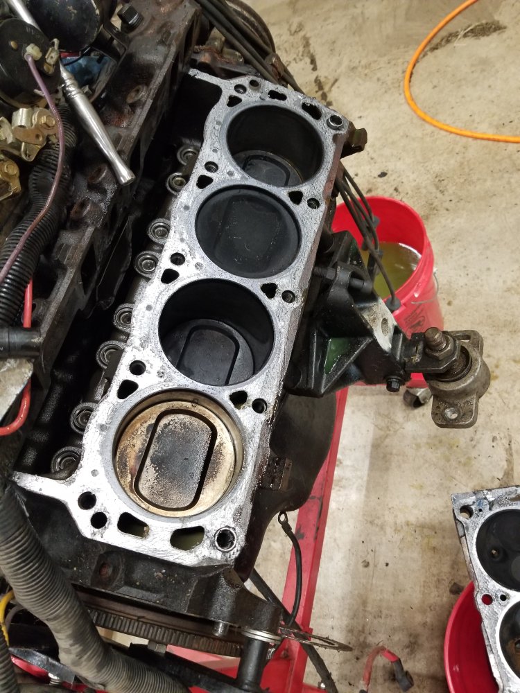

Ok, here's the dumbness...
The cylinders look decent, #4 is a bit clean not sure why yet...
Now that I look at that picture there's an F3 stamping but on the underside of the head is a D8 I swear...
It looks like cylinder 4 has been ingesting some coolant and that caused the carbon to burn away. The rusty valve stem means the valve guides will need to be gently cleaned out with a reamer- by someone with experience so proper clearance is maintained. If the guides are really pitted, it's possible to get valves with slightly oversized stems and ream the guides to match. I'd do the other head, too, otherwise your apt to be back in there soon.
