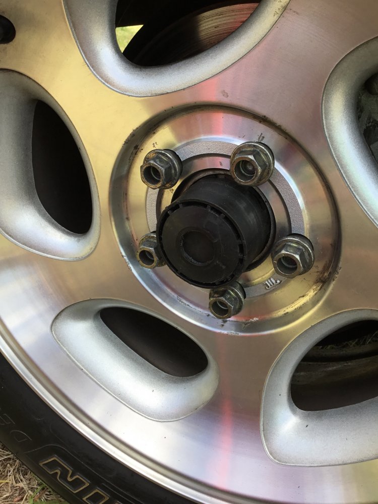

1. Already did vacuum hub mod as seen onU-Tube and Forums. Works good hubs lock manually.
