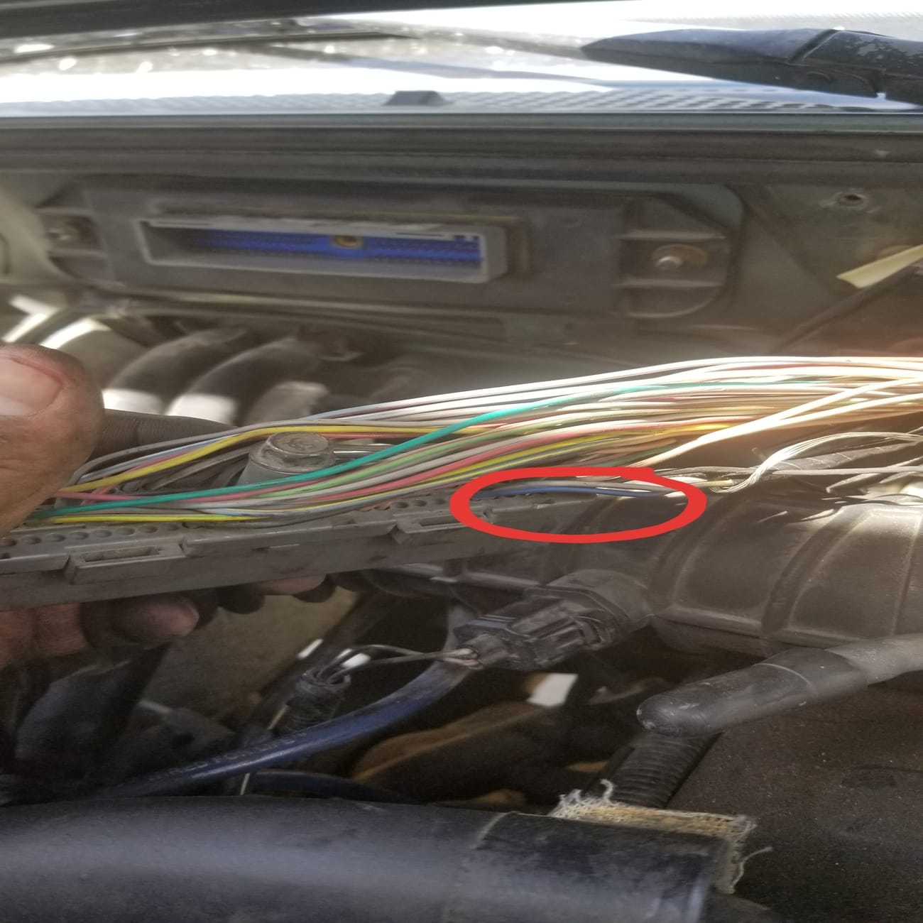

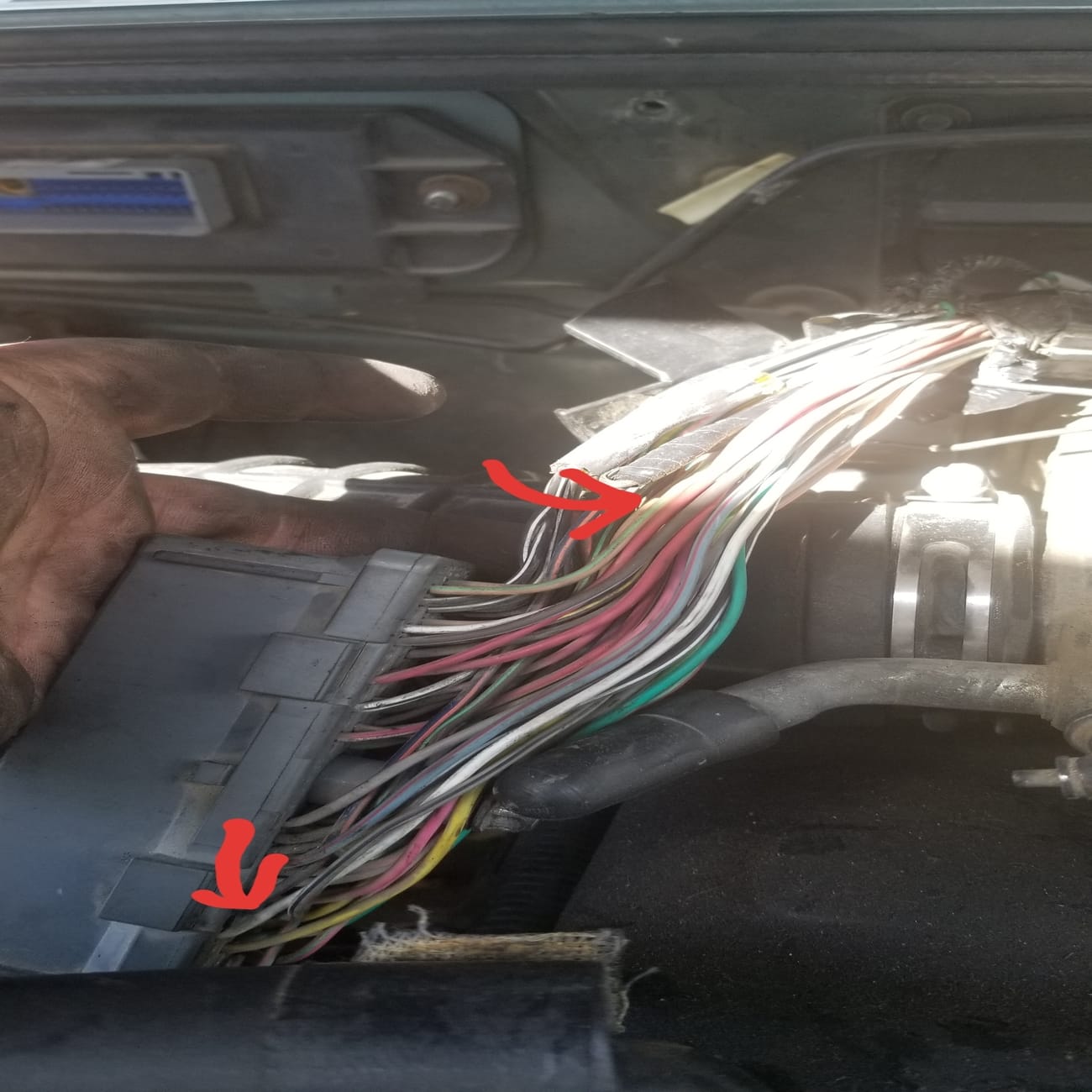

I finally made a "breakthrough" on the truck the wiring harness has been messed and 4- 5 cables have been spliced im guessing those are the problem.
Does anybody know where these wires go to?

where can i find a wiring diagram?

so pins 103,76,77,51,24 seem to have been soldered together and they have shrink wrap on them. My guess is that these are probably ground cables
pin 100 and 101 seem to be twisted together and attached to a wire that is BARE
pin 7 is also twisted into a bare wire
I want to concentrate on pins 100, 101, and 7 for now as they are attached to bare wires.
Does anybody know where i can get a pin out similar to the one attached, it took me a good half an hour of googling to find this one.
I might try finding a new harness at the junkyard, this one seems to split into 2 the connection is attached to the air intake from there it goes to the fuse box and a couple other components.

That is pointing to a ground or power problem, and if the harness has been monkeyed with is definitely a good place to start... deal with those at work a lot, everything our engines go into has solid suspension (forklifts, cranes, zambonis, boats...) so things vibrate a lot and grounds break off, sometimes fuse pins corrode, or a connection is somehow overprobed or something... After checking on that yes the ECM could have a bad buss for the power or ground circuits, it happens but is less likely than you would think...
