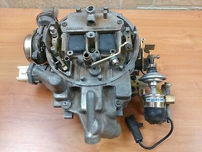

It's easy to tell a 2150 from a VV, take off the air cleaner and look. If it has a choke plate it's a 2150, VV's have black sliders that move back to open the air flow. Variable Venturi carbs worked great if they were set up precisely following the procedure, if the tech skipped steps it never worked. There are some adjustments- the seats that the metering rods slide into, for example- that should never be altered because there's no way yo correct them after they're screwed up. This is a top view of a VV:

Yea mine's definitely a 2150. Im trying to make the poor thing run "good enough" until I have the time and money to throw at all the parts to convert it over. It starts up instantly right now so I should probably leave it alone until later. I wanted to know if the cruise could work before I did the conversion, instead of doing it only to find I had 5 useless buttons on my wheel. Thanks for the help, all! I'll be making some updates when I finally start building this thing. Work is slow because its in storage an hour and a half away from me right now.
