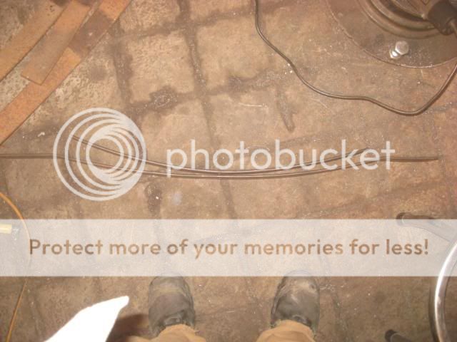

that showed how to reverse spring eyes, and the way that is done is to bend the springs so the arc is reversed. I figured that if you can bend the spring backwards, then you could also bend the spring MORE than stock. I've done that on one spring so it matches some others I have that I'm using for another project. It wasn't hard, I used a 12 ton hydraulic press that's worth ~C$120.00 at P.A.
Some pics so you get a better idea of what I'm talking about;
I put in the reverse bends that you can see ~ 6" in from the ends
I moved the spring about an inch each time and used about 4 strokes of the jack handle after first contact.
original curve
half done
finished
It works as proof of concept. I have heard that they won't last as long as factory lift springs and that makes sense but its cheap. I'll be trying this on my b-II when I get a chance.
Oh, and be very careful!! I broke the first spring I tried this on and wacked a finger pretty bad.
After that I made sure that my hands were not in line with the direction the spring would go if it breaks. That was simple, I just moved the jack handle over a few inches
