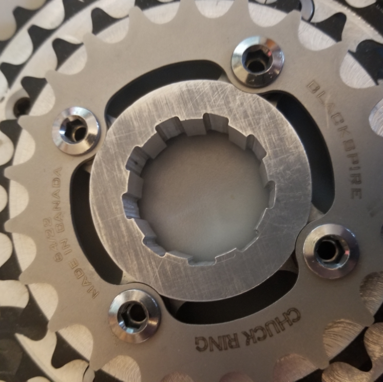

I drilled 2 small holes in corners of what would be the keyway corners so that I would have a final reference point; then number of larger holes to remove the majority of the remaining material. A cut with the hacksaw to join the holes and some file work to smooth everything out.

Some piece of machinery on the neighbour's farm had a lead screw with an unusual pitch (not standard metric or imperial) that failed. He wrapped a silk ribbon on a piece of rod in helix of the correct pitch, scribed that onto the rod and then proceeded to cut the screw with a hacksaw. It was about 3' long; he did it all with 1 blade for the saw, and when he finished it looked better than the factory piece.
When you learn from craftsmen like that, my level was minor.
And what hurt with my project - Blackspire came out with a 38t rear sprocket a couple years later. So, the bike has a commercial gear now, not the fancy one I made.
