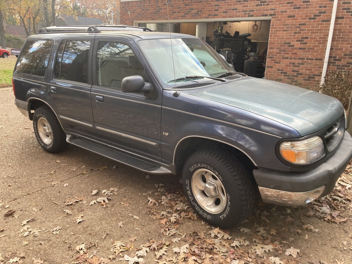

Pics will be posted tomorrow. Just got home from the Maiden Voyage with wife.

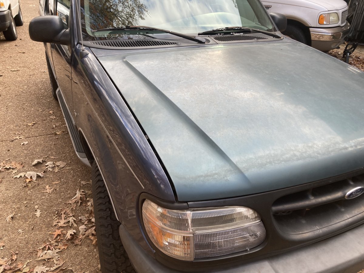

Green hood was the best of class at pull-a-part for several weeks. Don’t care- function over form.
In 60k miles I’ll have killed the drivetrain and it will be ready to donate to a ranger following a rebuild.
Thats a good looking SUV, even with the off green hood. I think it would be a keeper. A great grocery getter and as you said road trips.
