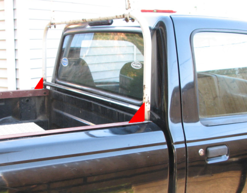

All the headache racks I've built vibrated pretty badly when going down the road without some sort of additional bracing:

yea id like to run some bars or bracing like that back a little further just havent decided how im going to do it yet lol...it does vibrate a little not enough to notice though yet
but i do agree it needs something
How do you guys attach these to the bed?
Bolts in side or top?
Is stake pocket used?
i just used 2 inch angle on the corner of the bed and ran several self tapping screws into the bed
Nice, I made mine in abou that amount of time but its a little more high tech and I fogot to brace it and get goin in the 55-60 range and it rattles pretty good. But bed rails right up tight to it, that helped alot for sure.
