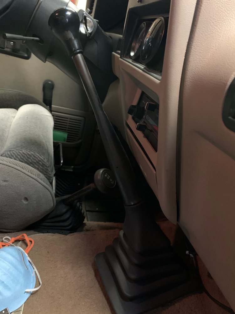

here's a pic of how close the shifter is to the dash in 1st gear.

Thanks for the pic. Looks like enough room to operate no problem. You said that you had tried to use a later cover on your '94 M5R2 but gave up trying. What modification to cover/trans did you attempt? Curious...
