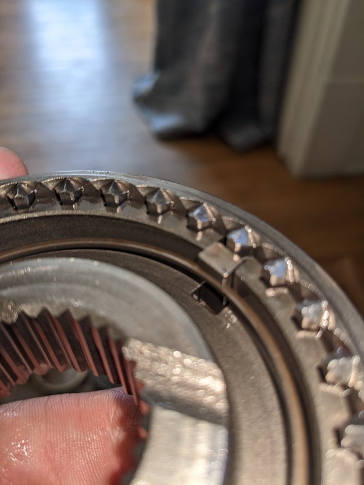

GOOD NEWS (for me not for you :haha:)... I got it apart today and it's not the multi syncro design. Someone else is going to have to be the guinea pig xD. I've got the 30 tooth reverse design.

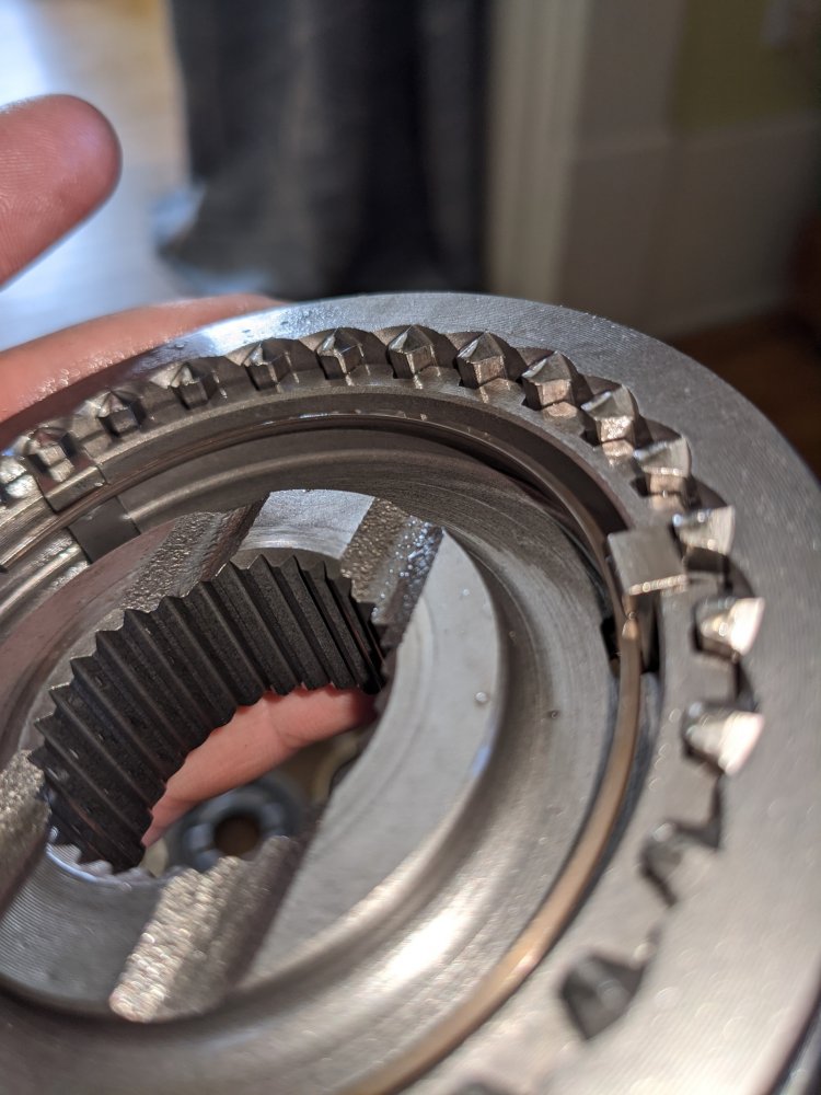

As far as my rebuild goes, I'm going to replace all the bearings and syncros along with the reverse gear. The engage teeth (IDK the name - the teeth on the gear that engage the syncro collar) on the reverse are totally chowdered - probably from my (and the previous owner) beating it into gear after the syncro wore out. Along with that, it also wore out the reverse syncro collar (again, making up terms)
Bad syncro collar (Reverse):
50834
Good (5th):
50835

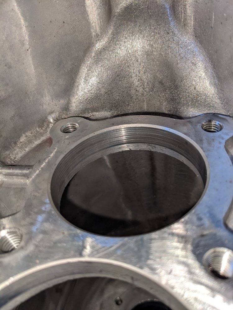

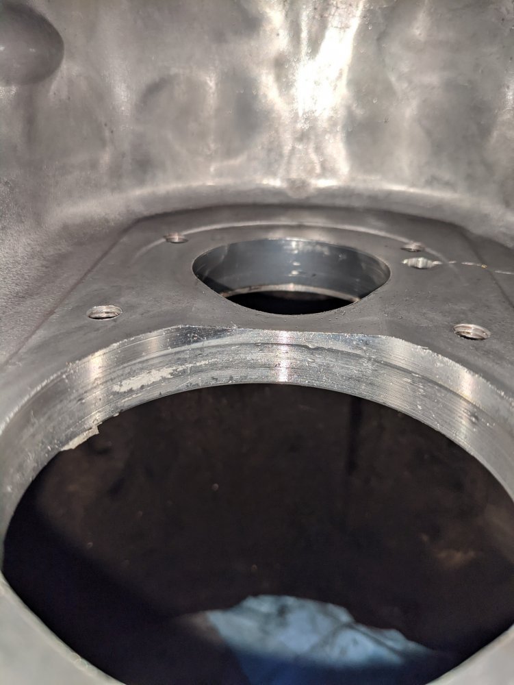

I've also got some wear that I'm not familiar with, if someone knows a bit more about this kind of stuff and could give me some info about it I'd appreciate it.
I have some on where bearings sit in the case. I can feel some pitting/striations, but they don't feel as deep as some wear that I've felt on a chainsaw cylinder that went bad (but that totally lost compression from them - don't cold rev your saw!!):
50836
50837

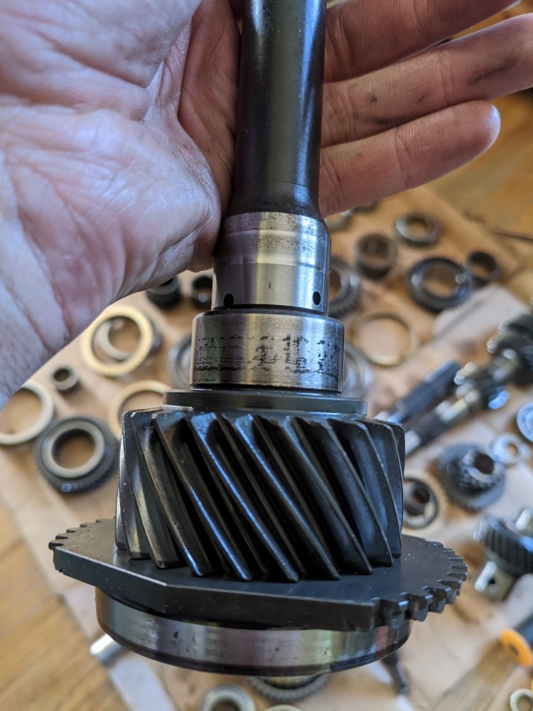

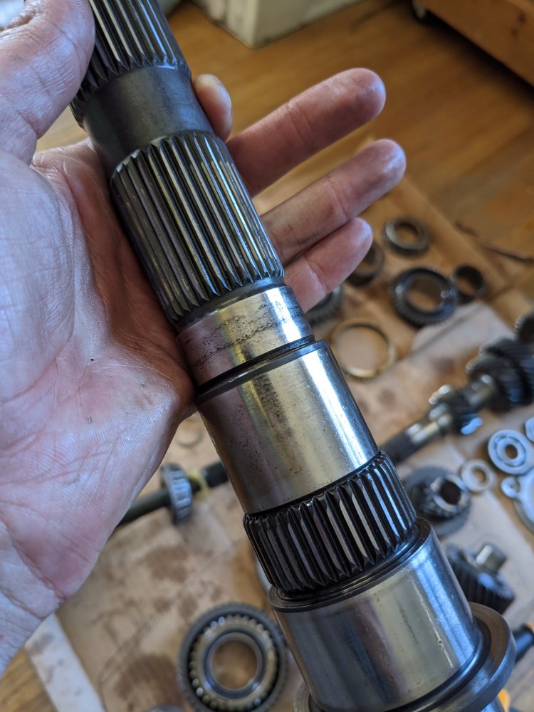

There's some strange discoloration (is it wear?) on some of the spots that bearings sit on the input and output shafts.
Input:
50838
Output:
50839

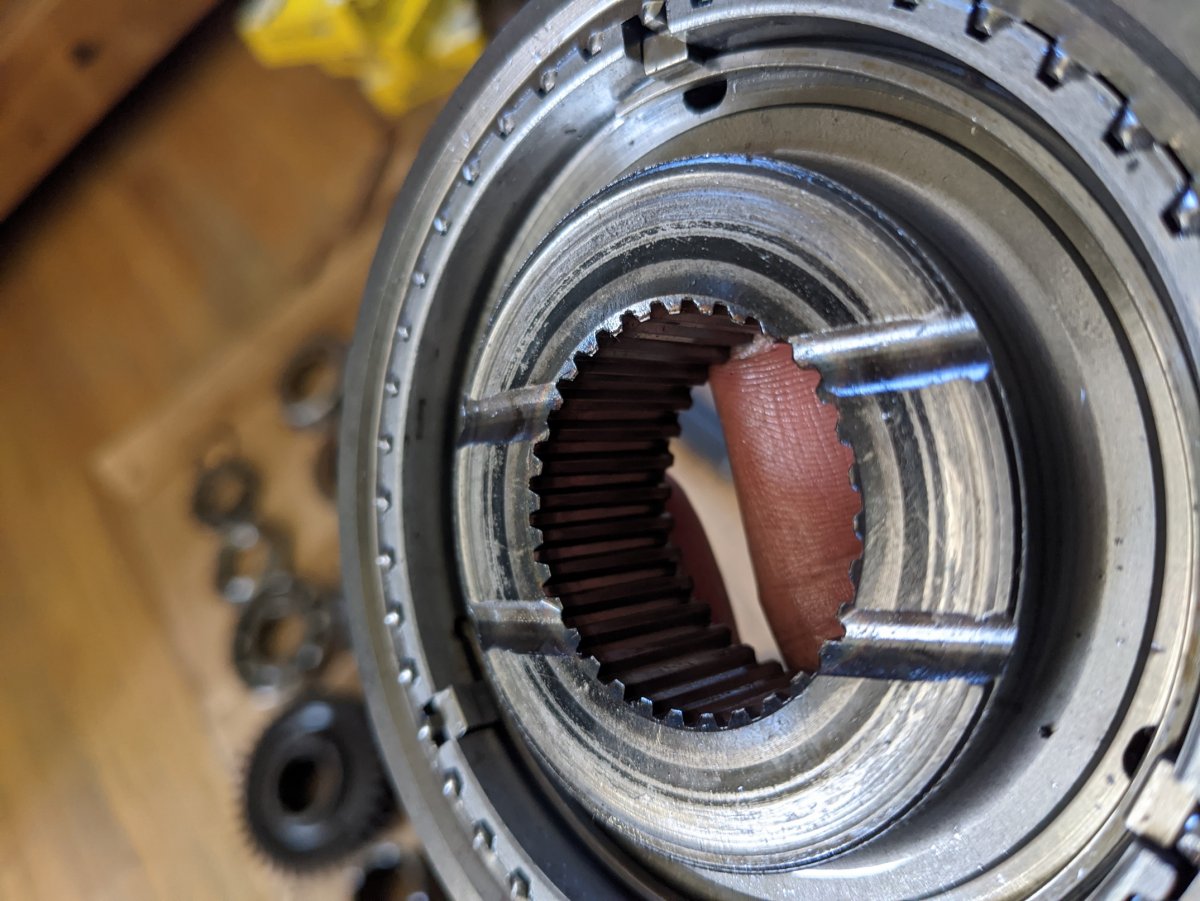

Also I just thought this was cool/weird but here's the 3rd/4th syncro hub. This is the side that faces the back of the thrust bearing. I definitely have to replace it. These striations are mad deep:
50840

Right on... I thought it was 2nd gear that was in question? Not 5th/reverse? The 30 tooth 5th/R variation started in the early 90's... '88 up to some point had 36t 5th/R.
Dunno if I'd worry much about that discoloration on the input and main shafts. That's just where your bearings sit... if they're not loose after you press them on, I'd run it.
I also would not worry too much about the places where your bearing races ride in the case. Every one I've torn down has looked about like that and it's hard for them not to when you're sliding parts through them at an angle during assembly, often several times. I would for sure check the rear bearing retainer and replace it if there is ANY sign of wear where the races sit... I had issues with that on one of mine.

Yeah it's second, but the teeth on reverse seems to be how sellers identify the kits. Sorry for the confusing text.
