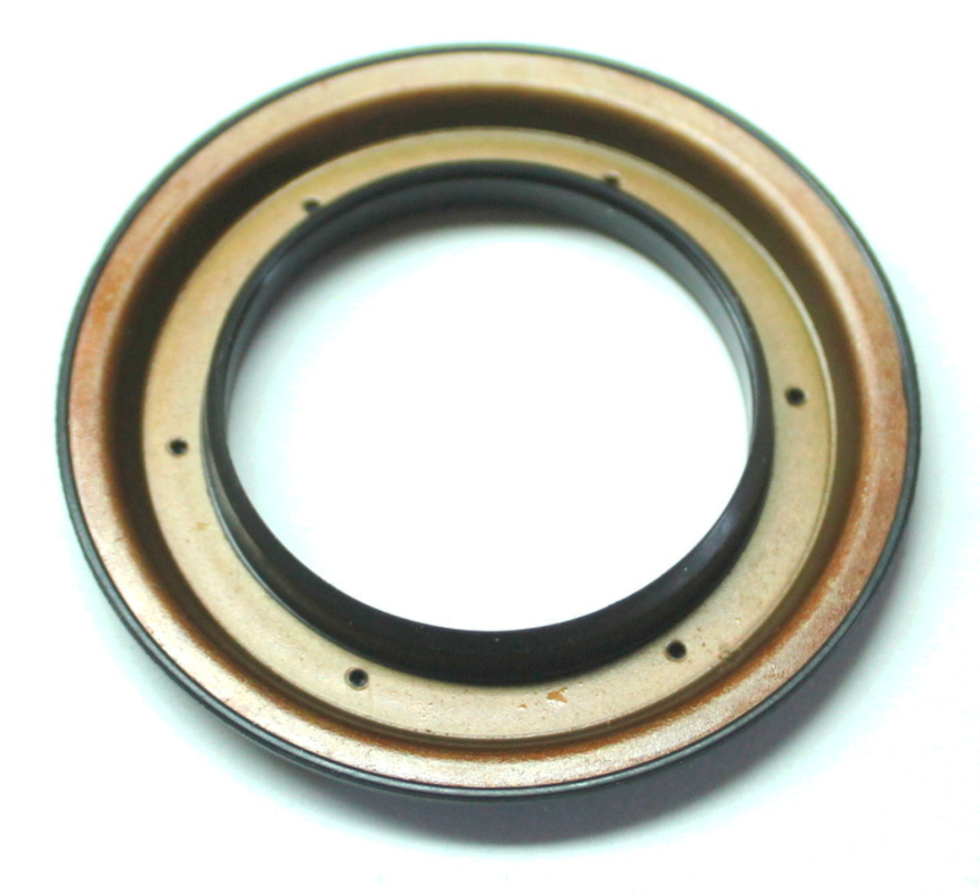

I thought I figured out what was wrong with the last rebuild - When I tore it down, that front bearing baffle (this part: E8TZ-7040A)
was a bit torn up, I think it had gotten pinched between the front retainer and the case because I kinda just put it in there a bit loosely. I thought that might've thrown the tolerances off, but I put it back together, re-measured with the proper depth mic!!, ended up with the same 0.146" stacked shim, and it still rattles. this is the second time I've put it back in. I used grease to hold everything together this time, so the baffle was definitely in the right place this time.
