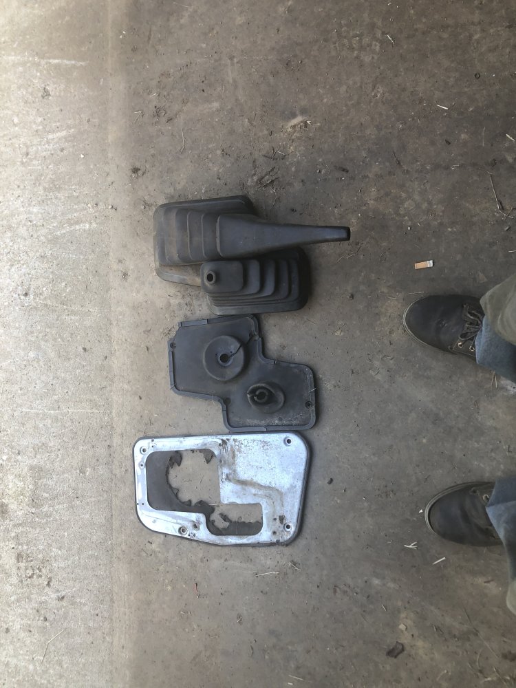

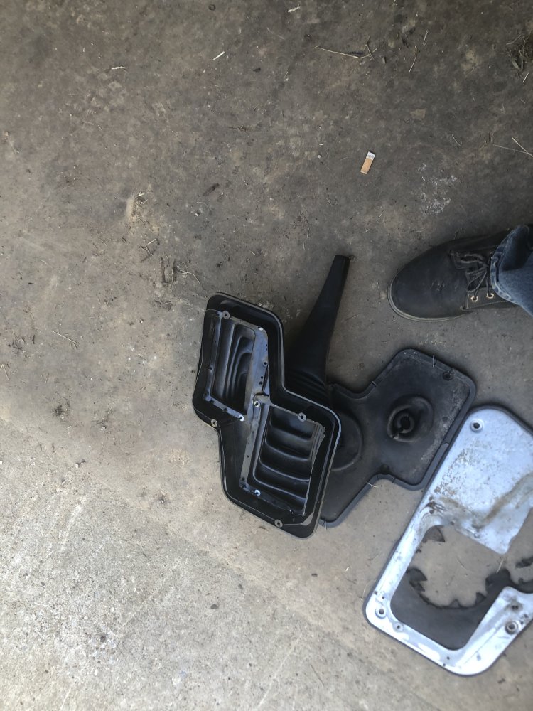

These are made by IRVIN transfer case boot 277532 the bezel 27624 1 shifter boot I have 3 they appear to be identical 276237 and 276490 third one has no visible number. Like another said get some belting , mud flap or some kind of softer rubber and cut one out. If you need measurements , I'll gladly get them for you . Good luck
Thank you for checking. That first number resolves to an ebay listing, so presumably those parts might pop up from time to time.
Flat rubber sheet works fine for the trans shifter, and I plan to buy the 6L5Z-7277-C next time I'm down by the dealer, but now that we're talking about it, I don't really have a great solution for sealing the t-case shifter. Unlike the trans, the t-case shifter needs to move something like 3" forward and back, so without a bunched up/accordion boot, you kind of have to cut a 3" long hole in whatever you're using. IIRC my Jeep has something like plastic brush bristles turned sideways filling the gap, but that also has less air flowing in because the shifters are built into the center console.

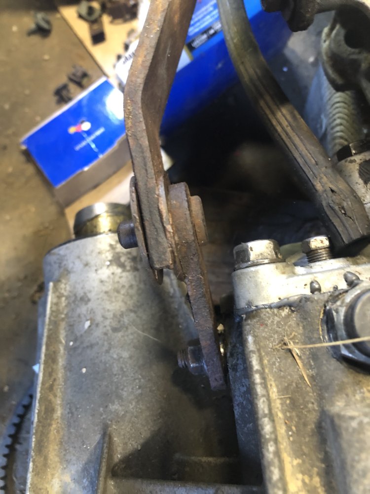

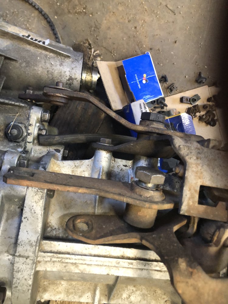

My problem is that using the shifters I have causes issues. 2nd gear is blocked by the tcase shifter in low range.
I can't follow that link, and I'm also curious what trans/t-case/shifter combo you have. I have an M5OD with the stock shifter, and a BW1354 manual with the shifter snapped off, so I literally have a piece of 1/2" pipe jammed over what was left and welded in place. So it's twice as wide as the t-case shifter ought to be, and I still don't have any interference, although it is very close.

My problem is that using the shifters I have causes issues. 2nd gear is blocked by the tcase shifter in low range. Really need to look into that. Kinda wanna change up my gearshift lever anyway. Prefer the look of the older angled ones.

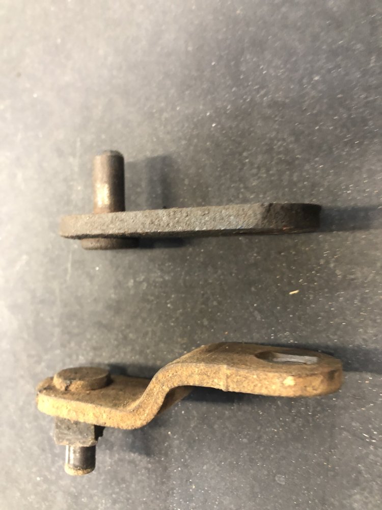

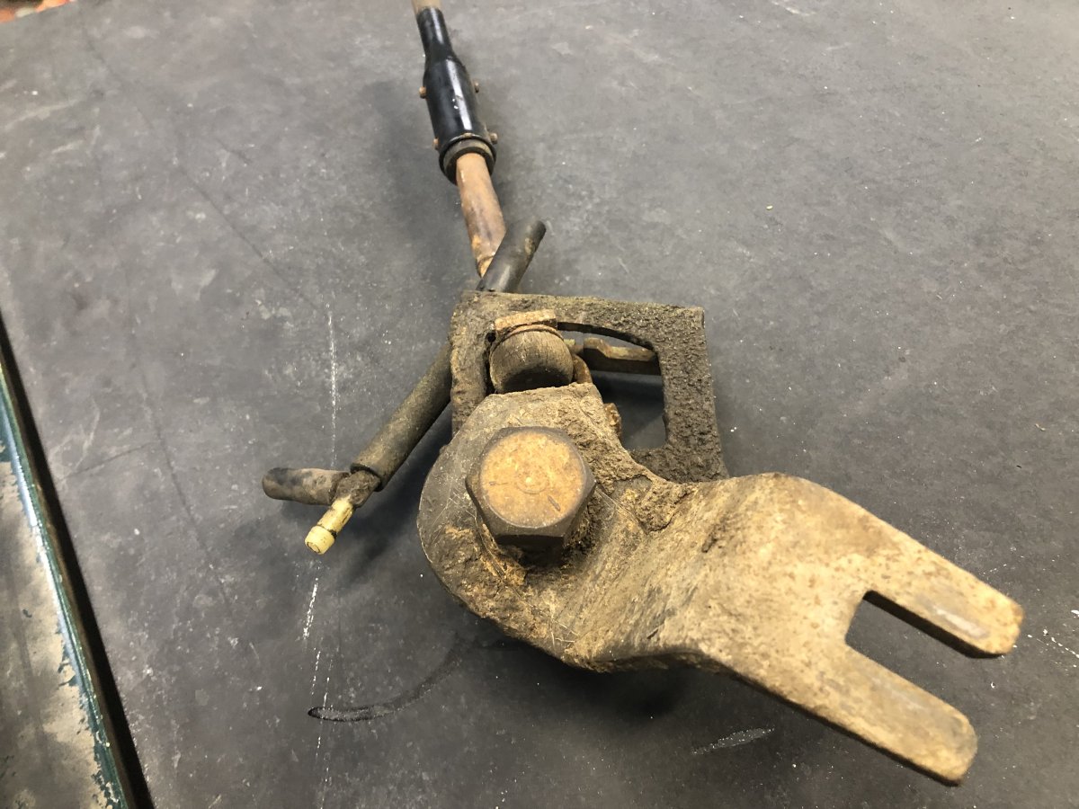

Here are the 3 shifters and the correct levers. The smallest is for the C 5 , Fm145 not sure about the 4 speed. The one mounted is for the AOD , FM 146, M5 , 1350 transfer case. The lever is straight and longer than the C-5. The one sitting next to the one mounted is for the 1354 transfer case. Notice the lever is crooked. The mounting bolt for all with the shoulder and bushing are all the same. Hope this helps.

I converted two from the AOD to the M5. An 88 and a 90. The lever on the 1350 should be around 3 inches long. In the picture the one mounted is a 1350 and a M5 out of a 93 Ranger and 87 1350. Just went out and got All 4 shifters . The 1350 and 1354 other than the offset on the fork and lever on the case are the same as far as mounting and length. The other two one 84 and the other 86 I believe. Both are different from each other and the other 2. One will move the shift lever back about three inches , the other roughly about 1 inch. All 4 will bolt to these transmissions. I keep a rebuilt spare 1350 and have no idea which one is in what vehicle. Two FM 146's two M5's.
The "small" rubber shift boot looks perfect for the manual t-case upper. Might buy it, since a 1" BL has made it so I need the t-case shifter to sit about an inch, inch-and-a-half further forward relative to the trans shifter. Don't see anything for the lower/inner boots, though.
