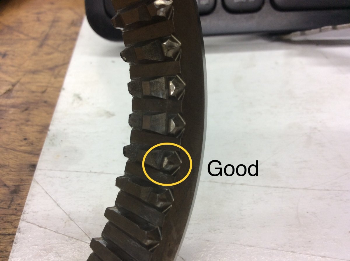

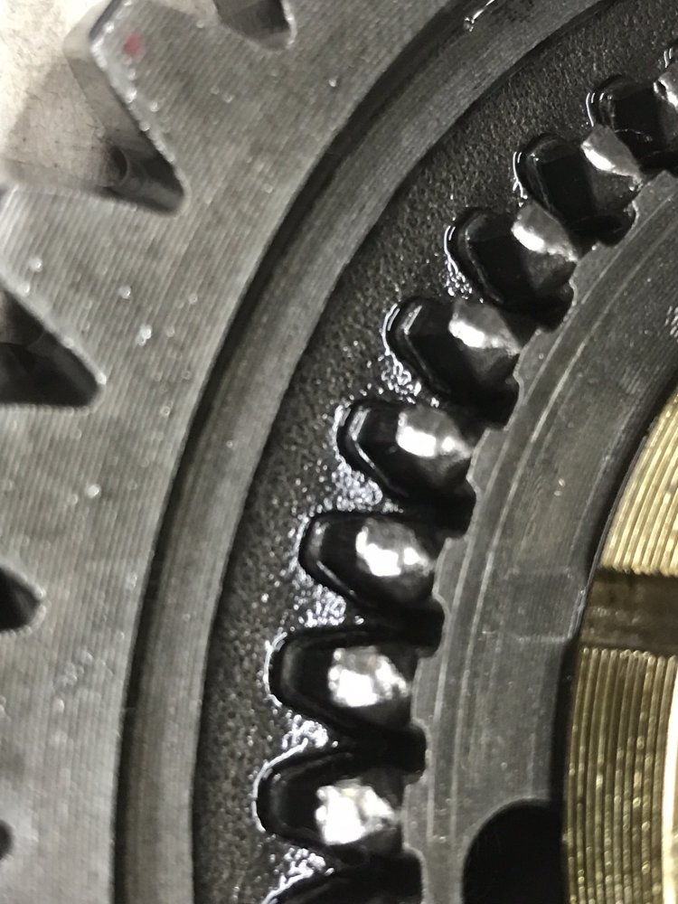

2nd gear. Some of the teeth are missing tiny chunks/rounded off... ordered a replacement

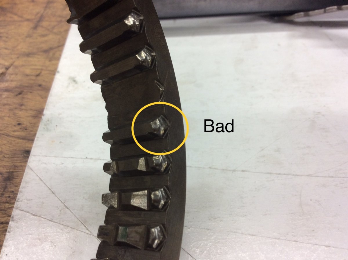

1/2 hub/slider, teeth look fairly rounded off to me. will replace

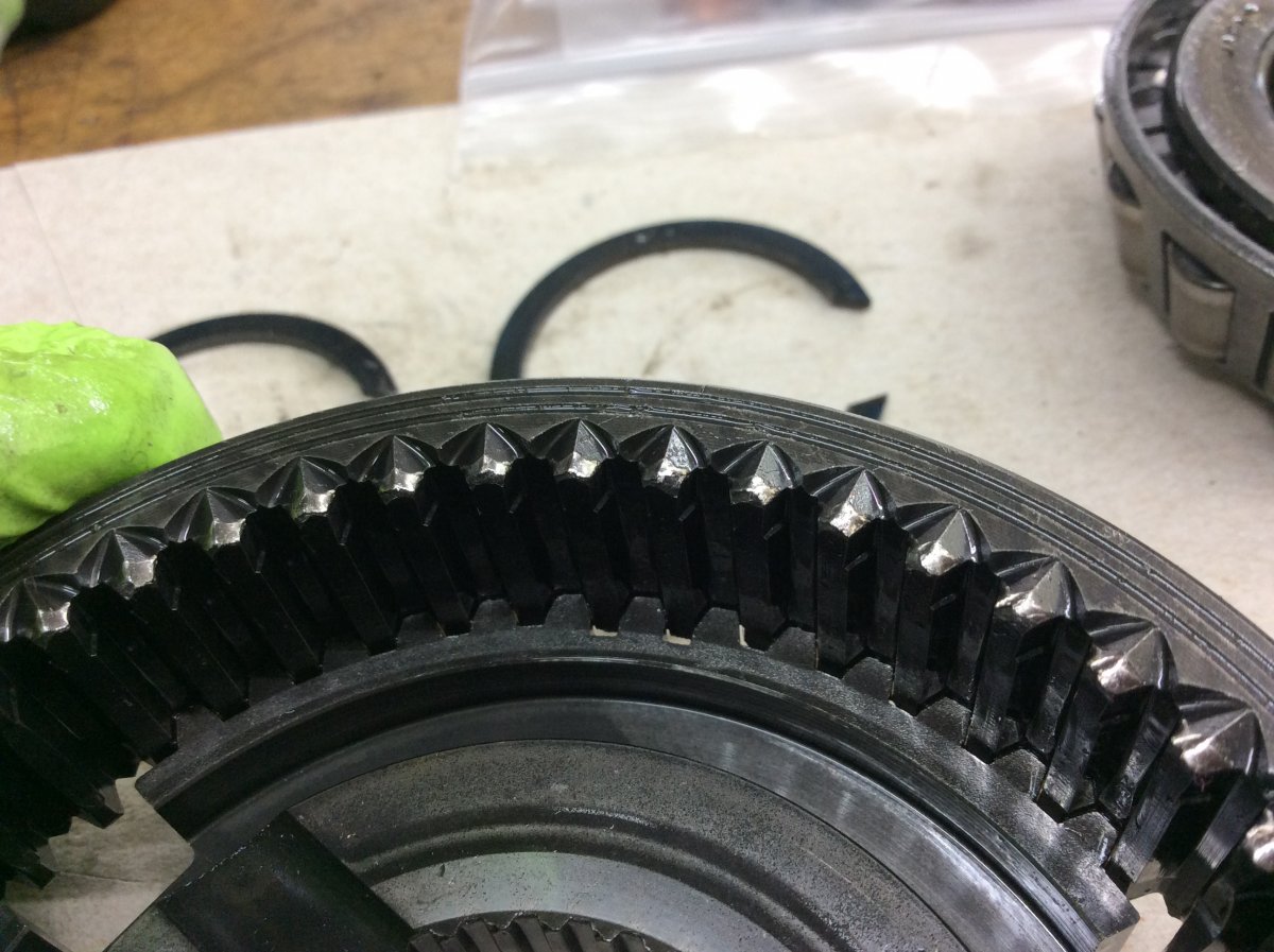

3/4 hub/slider, will replace this one too

Definitely have major wear on parts. Could the shim under the race have gotten misaligned and caused it not to set completely?
