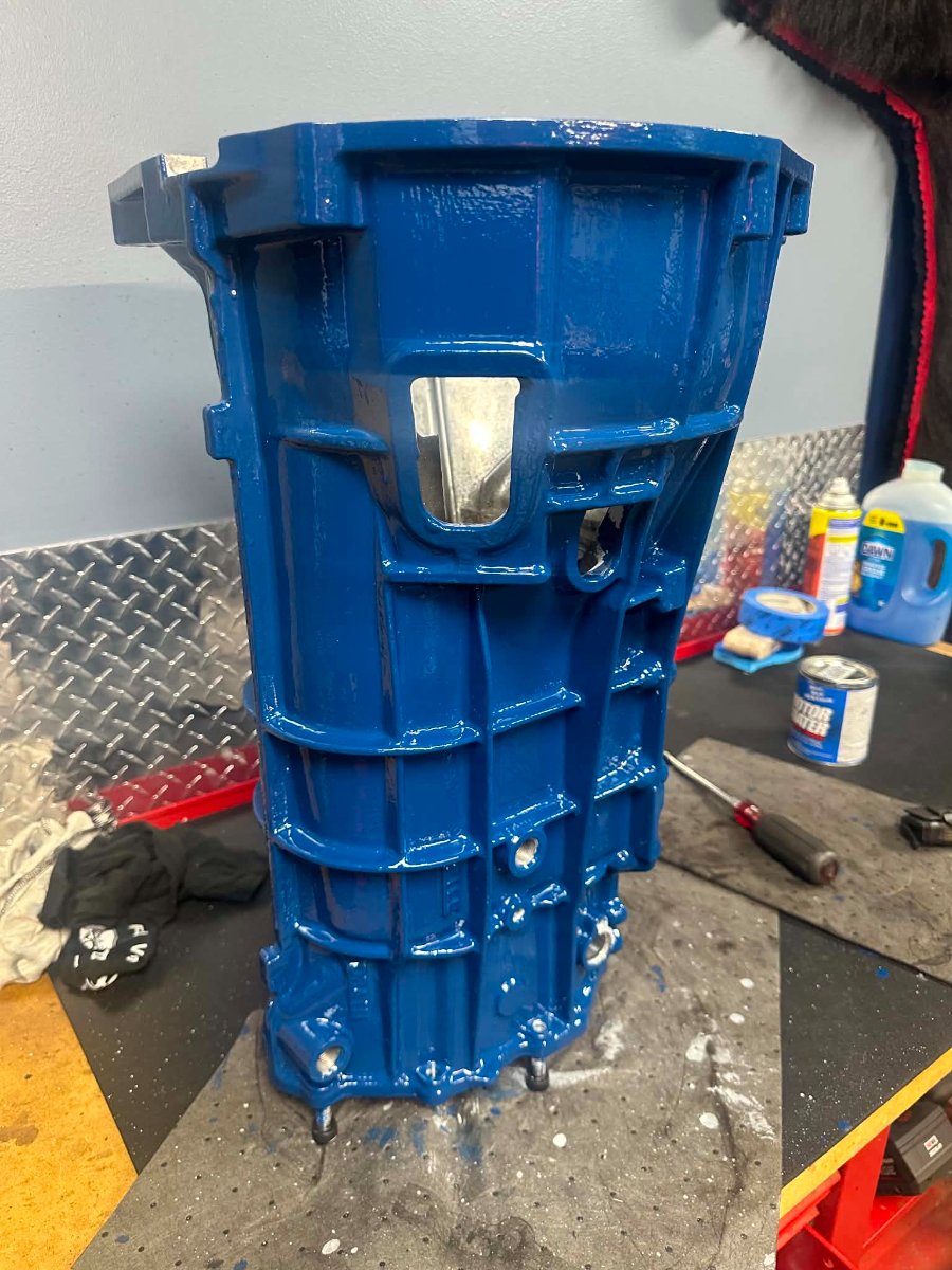

I did clean one really well, primed and painted. It's a side project that keeps getting pushed back. I used latex aluminum primer, not sure I feel about it. It peels off really easy even with the paint over it. Not sure if I just want to start over with regular primer that won't peel.
