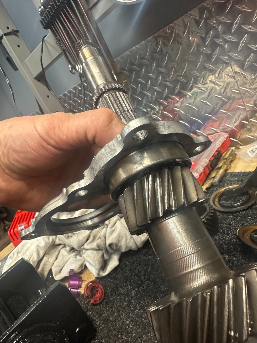

Are you replacing the rear bearing retainer with the "upgraded" steel one? I'm curious how that will hold up long term. One of my rebuilds had a bearing retainer failure less than 3000 miles in and the bearing race had started to wear into it. I have seen this damage on a lot of transmissions that I've disassembled. I'm kind of wondering if the input shims have something to do with it, IE if it's shimmed too loose then the race can move around more than it should or something like that.
