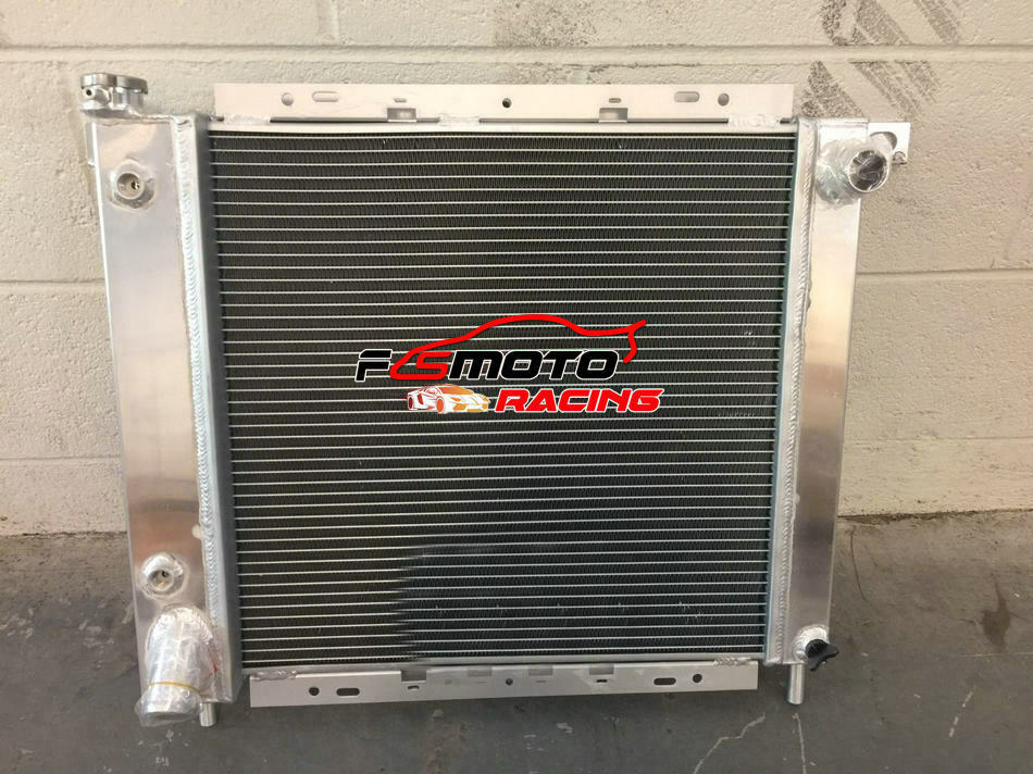

Here is one very similar to the one I am going to try in my 84, that I got on ebay for about $140. On the new 5.0 that I am putting in my truck, I am using the Explorer front end accessory drive, it should give me the clearance I need to mount my new aluminum radiator in the stock location. I am not using the stock heater box, so I can set the engine back a little farther also if needed to clear the puller fan. As I said before I have to change the radiator support to 85-88 style for this radiator to be able to bolt in, 83-84 radiator supports mount the radiator different.
Do you really want the outlet to point down like that?

I went to my ebay purchase history, but the listing for the radiator I bought was not available. Just do a search on ebay for an "aluminum radiator for 85-94 ford ranger/explorer"
Not sure yet, since I haven't mounted it yet. I'll probably use flex hose for the bottom outlet, so hopefully it wont matter.
