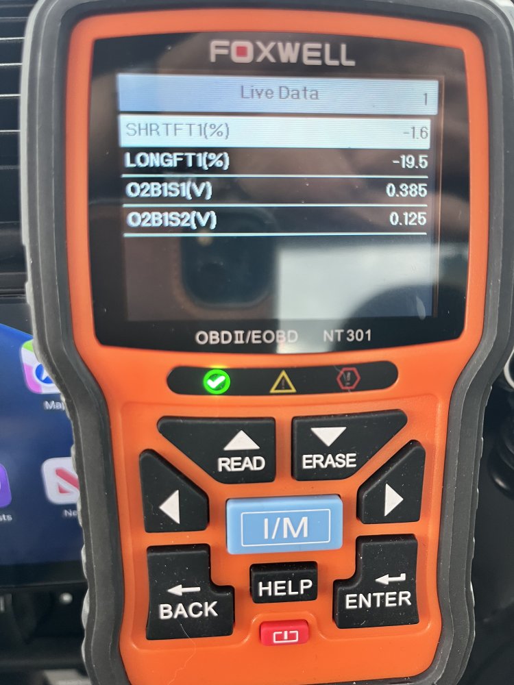

Anyone good with LTFT diagnosis? My long term is running in the -20 range points to a rich condition and I’ve begun getting horrible fuel mileage again. I’m thinking a possibility is a leaking injector. MAF is recent, O2’s appear to be working properly based on the varying voltage while driving but I ordered them just in case. No vacuum leaks which would present as the opposite and show the ecm adding fuel instead of subtracting it like it’s doing. Clean K&N that’s not over oiled. New exhaust from the cat back. No codes pending either. I’m going to pull the plugs when it cools down….just looking for ideas of what else I should probably look at.

Thanks guys. I’ve tried the flooded engine start procedure and it didn’t start. However I don’t completely trust that test simply because if it’s a single injector that’s sticking/leaking it probably wouldn’t start on one cylinder anyway. I’m going to try the sniff test and also run it without the K&N. My MAF data looked fine when I used that data set earlier with the fuel trim. What gets me is my short term looks okay….however that isn’t conclusive enough because the LT is what the fuel map table will refer to over an extended period of time from my understanding. ST is only trying to make small adjustments whereas LT shows the true problem and will cut or add fuel based on the map. It’s weird because it stays around the same -14 to -20 range at idle and throughout the rpm ranges. That’s why I ordered the O2 sensors to rule out a bad signal reading rich all the time. I’ll have more time Saturday to really dig into it because by the time I got home last night, pulling all the plugs wasn’t a good option.

Figured I'd update this since I've fixed my poor mileage after throwing a bunch of parts at it. In the end, it was the MAF sensor which I should've troubleshot first. My MAF was reading up in the 7.8-8.4 g/s at idle. This was the tell since the general rule of thumb is it should be x.x g/s for your particular sized engine in liters. So mine should've been at 2.5 or so and I missed that completely. I was too focused on why my ecm was telling the injectors to pull fuel since it was seeing a rich condition, so i was poking around it possibly being a lazy O2, leaking/stuck injector, old plugs not burning the fuel efficiently etc. Things I did in order which made no difference until I finally changed the MAF.

This is when I threw the Foxwell back on there to check the MAF since that's what the suggested issue could be and noticed the high incoming air reading which was adding a bunch more fuel to get it to 14:1 stoichiometric, which the O2 was reporting still rich and cutting the injector pulse time to a -20 on the LTFT.
Duralast MAF including the alum housing $89 - Fixed
