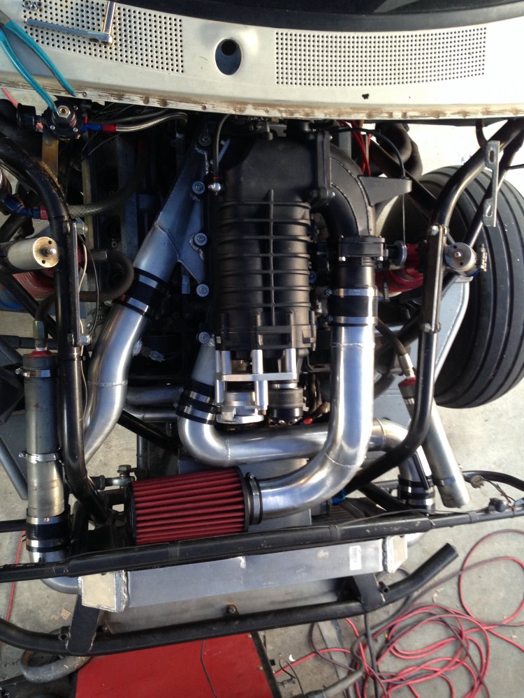

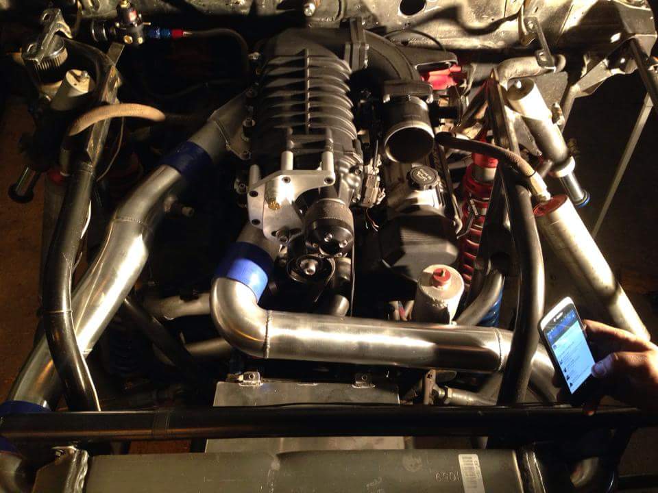

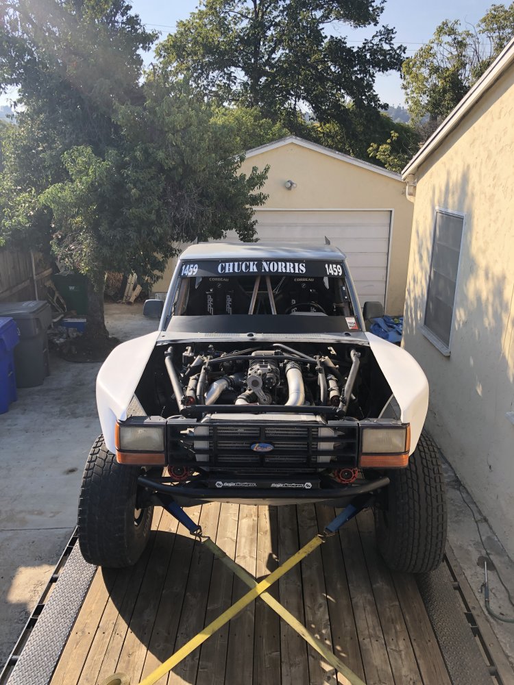

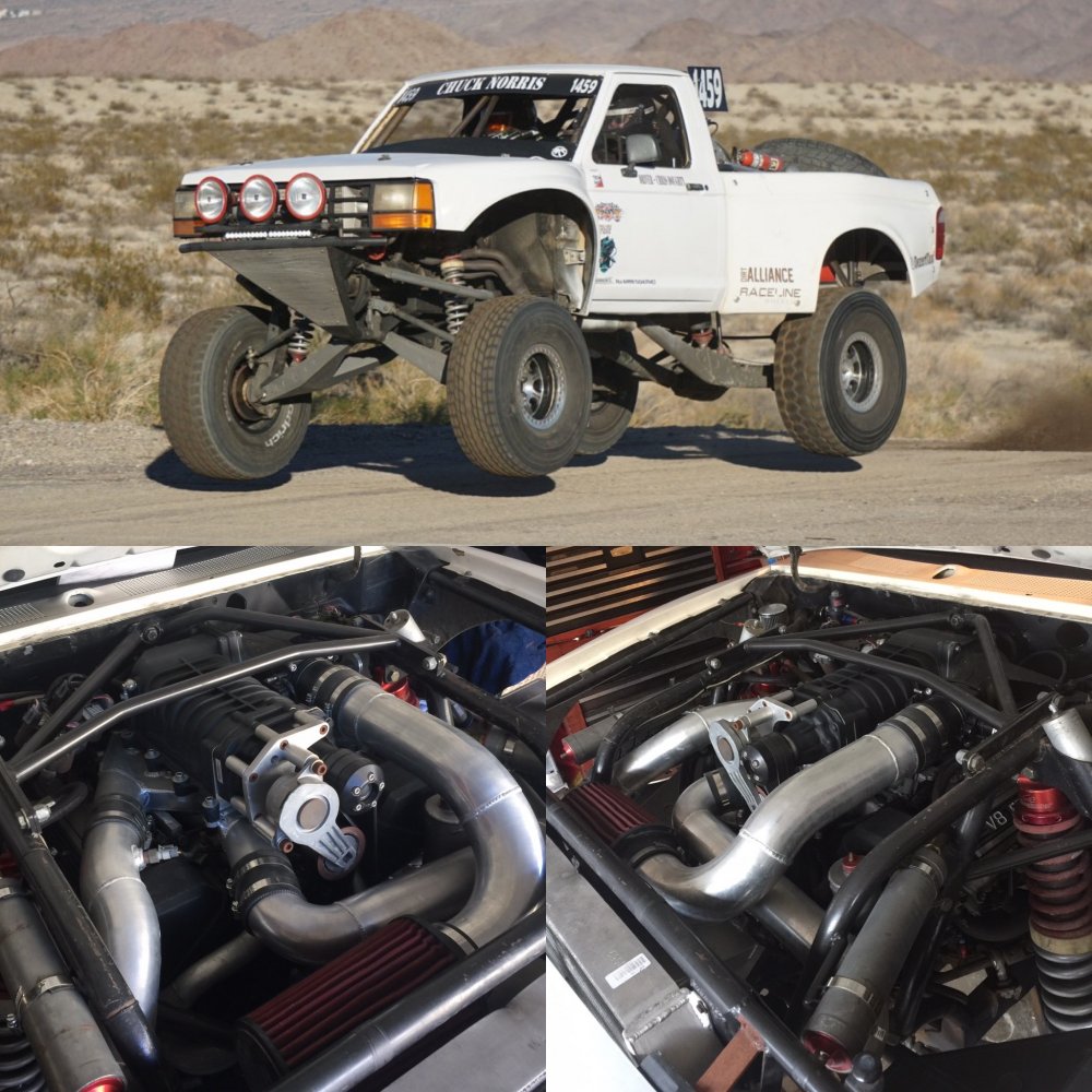

1989 Ford Ranger, custom frame rails and suspension from the front of the cab fwd, 1UZFE with a M122 supercharger on top 8psi nets around 333whp and 338fttq. Has a MegaSquirt II stand ECU its mated to a TH400.

Google supercharged 1UZFE Ranger there is a write up on a website called engineswapdepot. We had issues with cooling as well as making transmissions survive. After a few C6s and C4s a bell housing adapter for a Th400 solves the issues.
