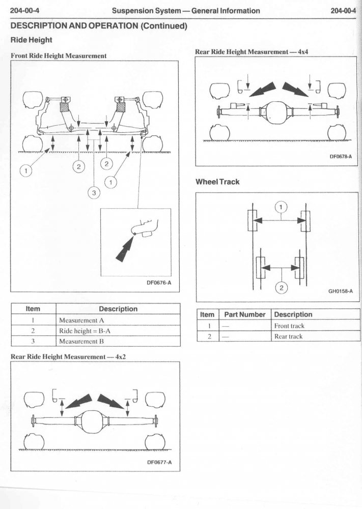

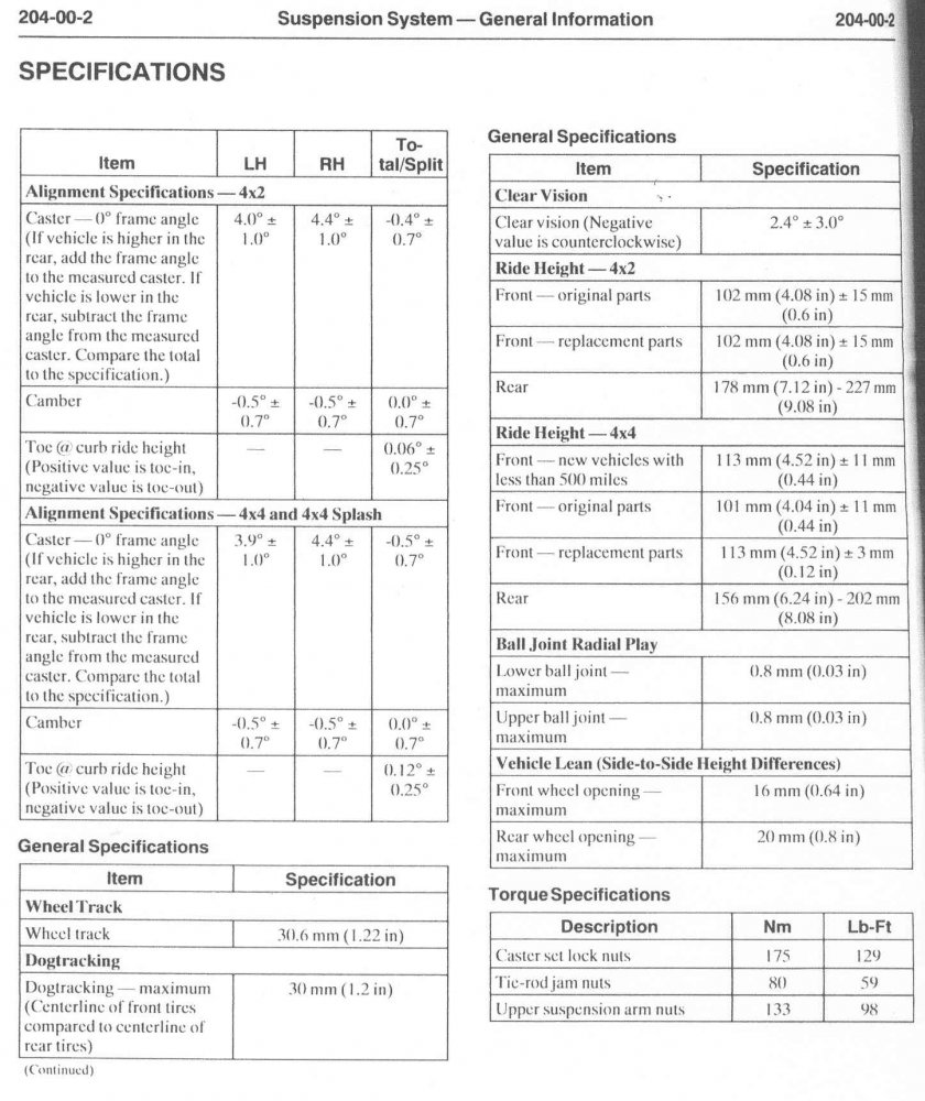

Yes, you can lower it usingnthe torsion bars. I turn the same amount on each side and drive around the block and then measure to the fender to make sure its equal height. Than i bounce it to make sure it bounces evenly
FWIW, there is a limit to how low you can get the front before you need to remove the front bump stops. That isn’t a whole lot so you may have to pull them to start. Also your next limit is the upper control arms, the ball joint maxes out and the arms are too short to do more than an inch or so of lowering at the fender (tire to fender clearance). Nobody currently manufactures lowering arms for the front. You can back the bolt out all they way and get a little more lowering plus flip the upper arms if they have replaceable ball joints, but your camber will be permanently out without longer upper arms or something welded in.

I'll almost bet the torsion were turned up a bit before you bought it. It costs zero money and it levels the truck. Lots of folks do it.
I put the specs and how to measure in my previous post. Measure where you're at now before you do anything.
I will add that putting it back to factory specs is the wisest choice you could make.
