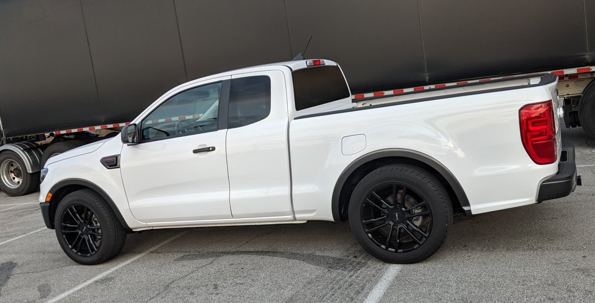

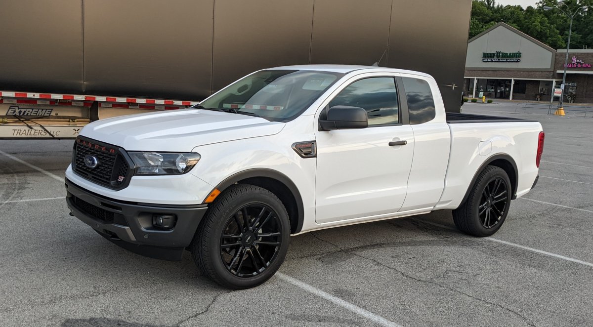

I lowered my 2021 ranger 5" at the rear and 3" at the front It looks great, it corners better, less sway, I can get in and out without a step ladder and I can use the tail gate as a bench.
I used Belltechs kit for the rear which is a well designed kit but don't use Belltech for the front as it has too much spring slop
because of poor design (my observation), I know of NO car or truck manufactures that does not make springs fit snug to their mountings. I would recommend coil/over springs from a company that designs them for the front of the new rangers.

A few photos of the what it looks like today
This looks really damn good. I'm a fan of this. I honestly don't know if I'm going to do this anymore to my truck, I'm leaning into the T-Bolt pretty hard and I might end up selling the new ranger when I'm done with my work on this one. But if I don't, I'll definitely be adding this kit to my new truck. Beautiful Ranger, Tinmender. Thank you for sharing your work with us.
Maybe I overlooked it but would love to know the wheel/tire combo and specs. Love the look!
I have the original wheels and tires on my lowered ford ranger. I used Belltech's rear axel flip kit (5") and the 2 .75"
front lowering shocks & stock springs (not the best). This is on a 2021 4wheel dr. ranger.
Derek
that white ranger looks way better at that height than the stock ones do. they are to tall
