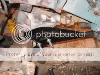

Another way to fix shock stud, this is on a d-28 that originally doesn't have a stud but if yours breaks you could buy the stud from any parts place that stocks the 'HELP' line of parts. This was on my race truck so two studs;

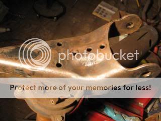

I grabbed the rad arms from my '87 and drilled two holes 2 3/4" apart, the front one 1" from the existing hole;

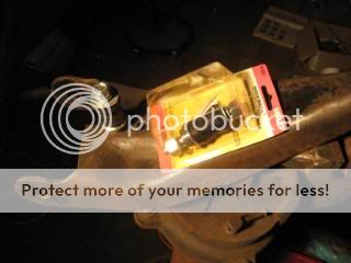

I bought and installed these shock mounts;
IIRC they were C$12.00 ea.
