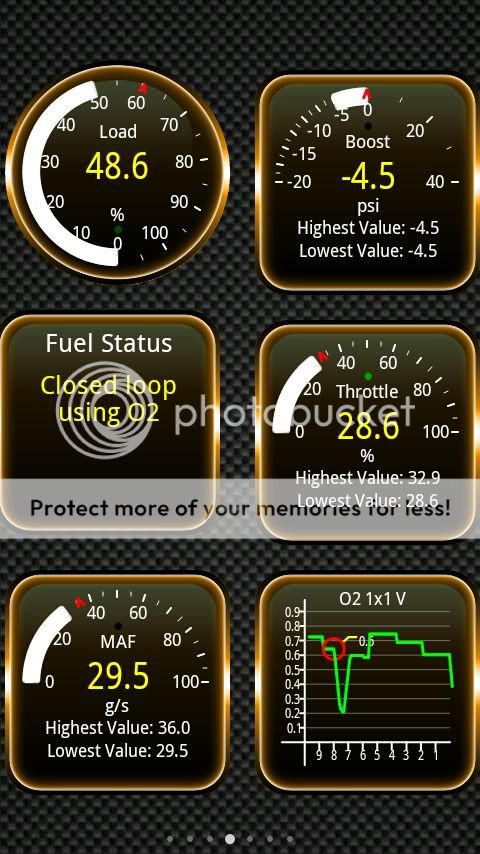

Here's a couple screen shots of the Torque program. The first one is at 70mph....

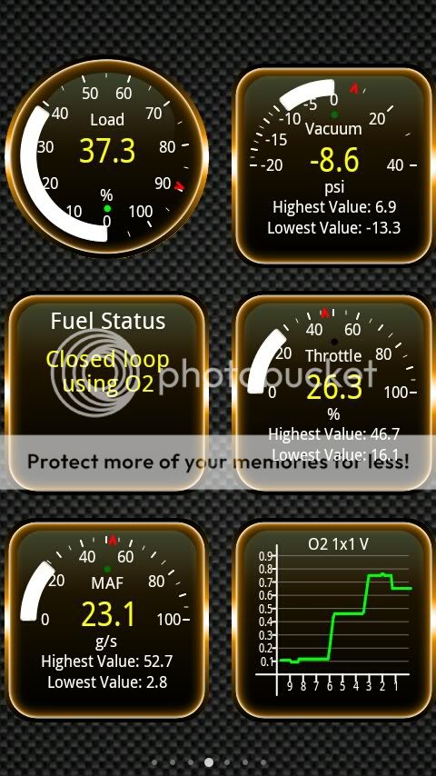

...and this one is at idle...

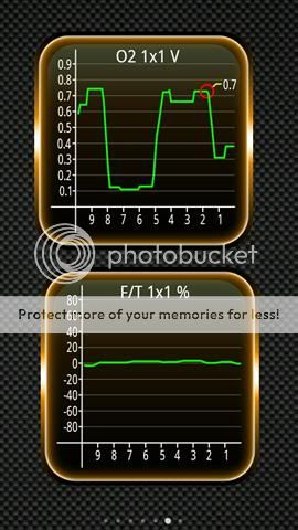

This one is showing the upstream O2 sensor voltage on the vertical and time in seconds across the bottom,as well as fuel trim for that O2 sensor. This was at 70mph. Does this look like a properly functioning sensor?...
And here's what it looks like at 60mph in 4th gear. All these were snapshot while on level road....
Dang....no pics.... Just in case you weren't aware, you need to serve your pics from an external host like photobucket, flickr, google picassa, etc.
My OBD-II scanner is on the way (scantool.net) from Amazon. I will compare values to what you have posted and see if anything stands out. Hopefully the included Obdwiz program is similar in function to torque.
