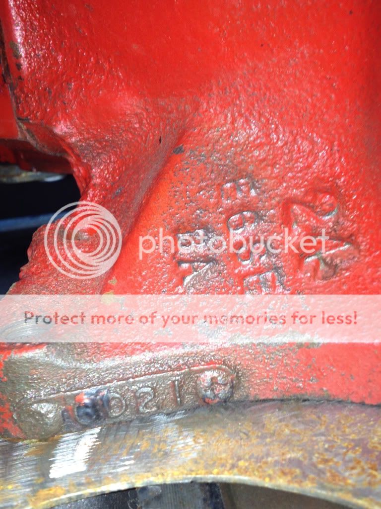

Really now? Then i guess i got screwed hard at Oriellys where i bought the engine and they said it was an 87 mustang. This is the casting numbers what can you tell it is i cant remember how to read them.
That is an 86 casting I believe. Does it have flat top pistons? If it does.... completely scratch the idea of GT40P heads.

This is the pistons that are in it. And i thought i had 1.7 rockers but they are 1.6 RRs
Yep, the 6D21 means cast in April 21 of '86'
Dave
Those are 87 style pistons. The 86 would not have fly cut pistons. So, I take it this is an Oreilly reman then?
