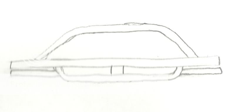

its perfectly fine if its not crash rated it just has to have a front hitch so i can have outriggers for my dogs i just want the tubes for looks and i think what i might do is black spray on bed liner as paint doesnt hold up very well
as for the bumper it self i like the idea of the look of the one on the bronco 2 with a second bar under the top and a brushguard (or hoop what ever you want to call it) off the bumper on the B4000 if i can put tow hooks on it thats fine
hey like i said anything is possiable. just have to figure out a good time to put pencil to paper (or welder to metal) definately can be done in one night best bet to get what you want is to help build it.
