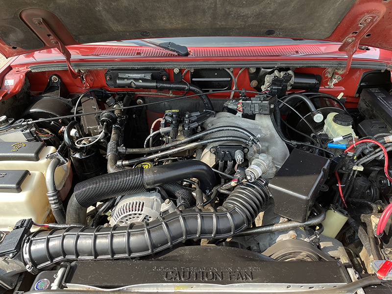

The 98+ aluminum upper intakes have a small coolant loop that passes through two small ports near the throttle body. Visible here running from heater hoses to intake manifold:
Looking for guidance on UIM and LIM removal/gasket replacement.
Probably don't need to completely drain the coolant, but you'll need to drain enough for the level to drop below the heater hoses. Many people delete this loop entirely because it serves little purpose. That modification is known as the "Hot Water Bypass" if it's something that you're interested in searching.
