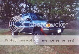

Any advice is much appreciated. Here's the truck about 9 years ago when I installed the lift.

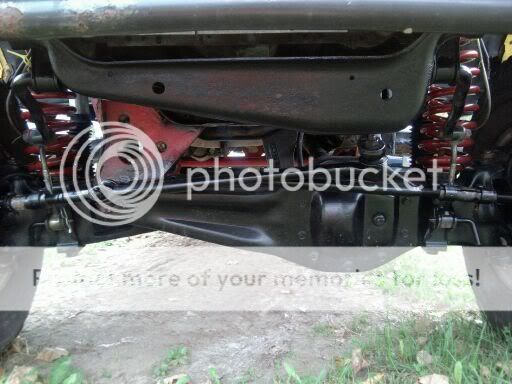

Ooo could I get a picture of your steering setup?

They're actually two off-the-shelf Moog passenger side links. I cut the passenger side inner rod at specific spots and spun it the inner remains 180 degrees to where the flattened tie rod end mount hole was positioned near the axlebeam pivot bolt instead of near the pitman arm and welded it up. The good thing about this is it also moved the tie rod link forward some to help with clearance of the drop axlebeam bracket.
The drivers side factory link I threw across the yard as hard as I could and proceeded to work....
I took another passenger side link and mounted it on the drivers side and mounted it up. To do this requires you to also buy a new adjuster sleeve and tierod end for the passenger side as well in addition to the tie rod link because the link diameter is slightly larger ( M20 vs. M22 iirc). The only issue with this is the bend in the tie rod link can come in contact with the passenger link if the drivers link isnt orientated correctly. Under normal circumstances, this shouldnt happen. If I wanted to I could simply cut out the bend and weld a straight piece of link rod in its place to alleviate the issue, but I will worry about that at another time.
Keep in mind, my tie rod link angles arnt completely horizontal as I'm running 8" coils up front. With 6" of lift the angles should be dead set near 0 degrees.
This is also great too because it uses factory tie rod ends which should prevent inspection issues that arise when you use heims or other means of rod ends. You cant tell I cut or welded the rod at all. The tech shouldnt know the difference unless he knows alot about rbvs, which most dont.

Gotcha (was hoping they were a factory app from somewhere). That's cool, though it appears you did not sleeve over it where you welded?
No, I didnt. I was trying to go for a completely factory appearance for inspection purposes.
