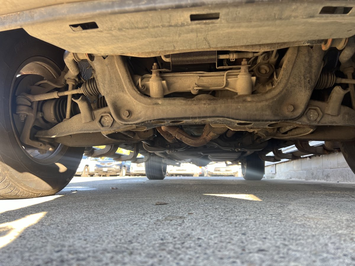

Definitely torsion bar...
I had a new used vehicle once :D
Torsion bar 1 is the stiffest = 2,900lb front GAWR; rear spring 2 is the "mid" range but I think they all give 3,200lb rear GAWR...

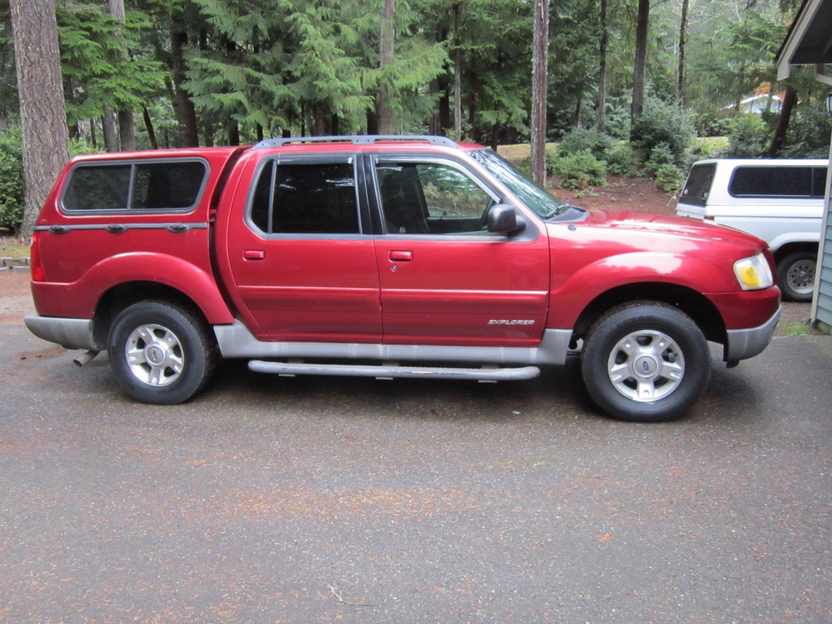

I'll have a Superlift front lift coming available in New Year (daughter wrote off the December calendar truck, I'm parting it up...) Shipping to Seattle would be expensive, but I might be able to get it to Vancouver, BC. Note: I have an Explorer Sport and 2 other 4x4 Ranger in fleet, so I'll be asking money for it, not giving it away (just setting expectations).
