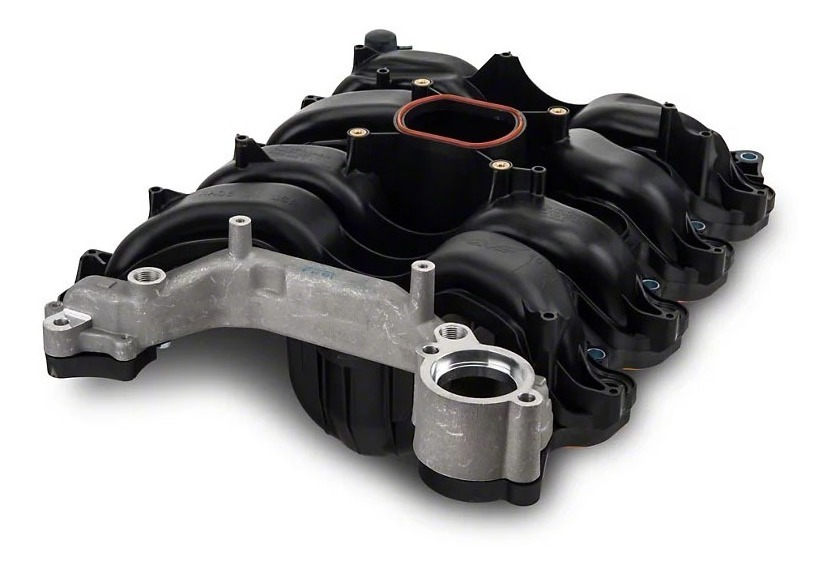

I had an '03 Grand Marquis with the 4.6. This is what the "good" intake manifold looks like. That aluminum coolant crossover is the fix. The original was plastic.
