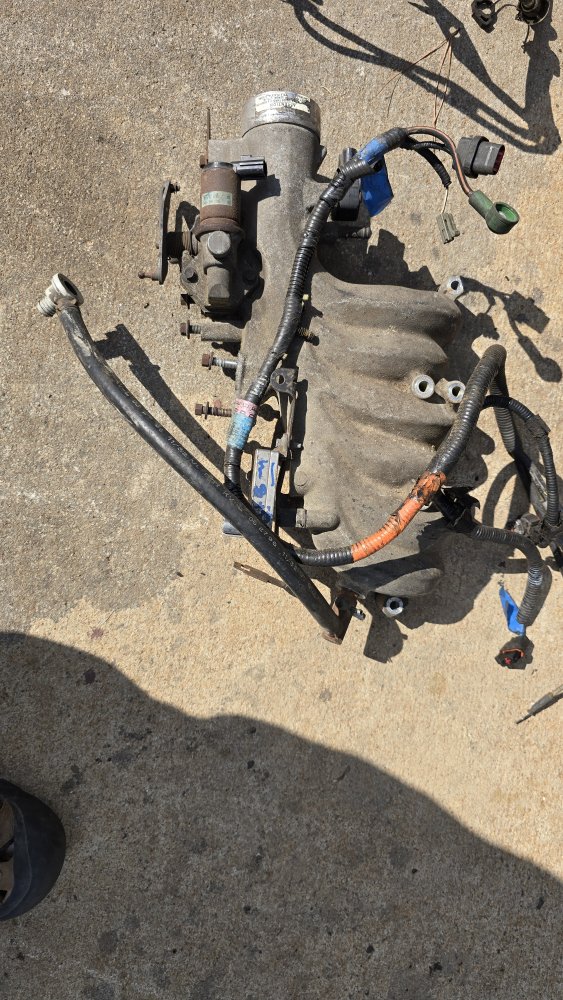

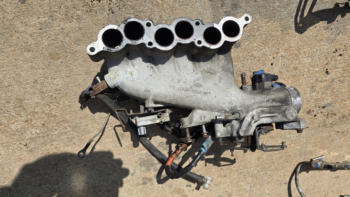

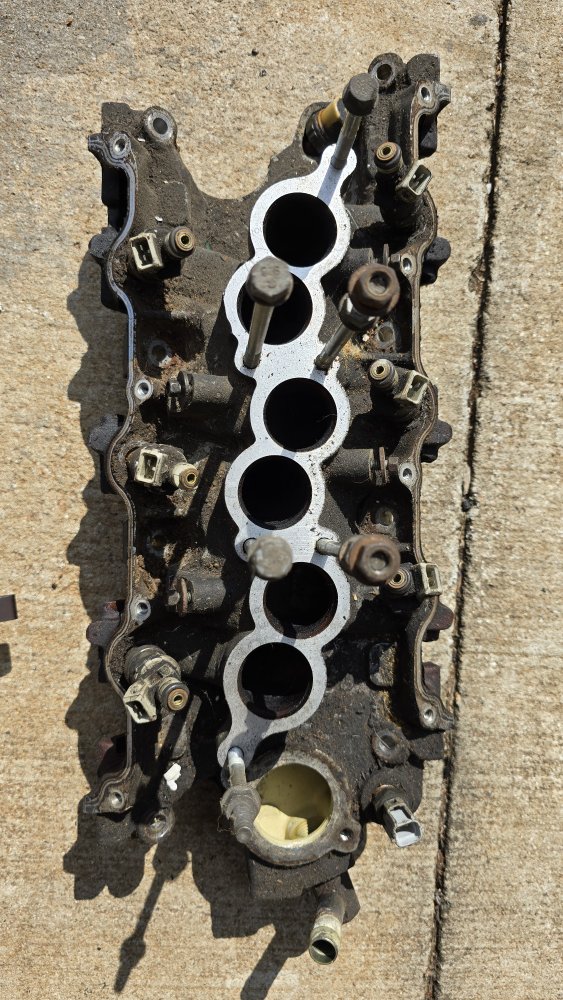

Are you parting out that 97 3.0? If you are, I would like to see the upper and lower intake manifolds..could you possibly post some pictures of those two items?
These are the photos I have right now. I'll try to get better pics later. I think I also have another upper intake - one of the ones with removable throttle body. Don't remember what year that is.

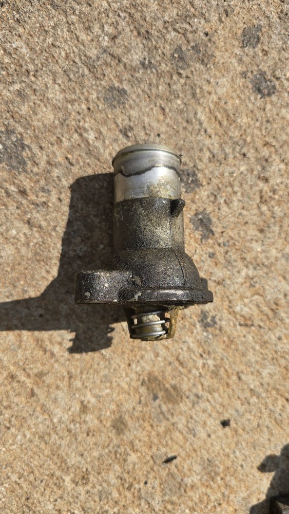

And the thermostat housing
Appreciate the pictures. The upper intake manifold with the removal throttle body is 98+...no need for that one. Do you have a price in mind for both 97 3.0 intake manifolds? These will be spares, as 93-97 3.0's are getting rarer and rarer these days. My zipcode is 96001. Could you let me know a total of those, parts and shipping? I would appreciate it. Hopefully shipping won't be to horrible.
