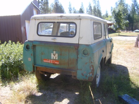

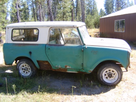

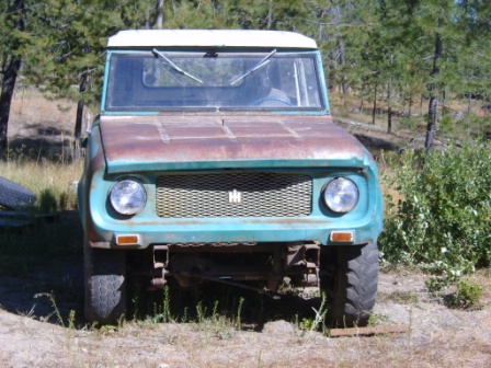

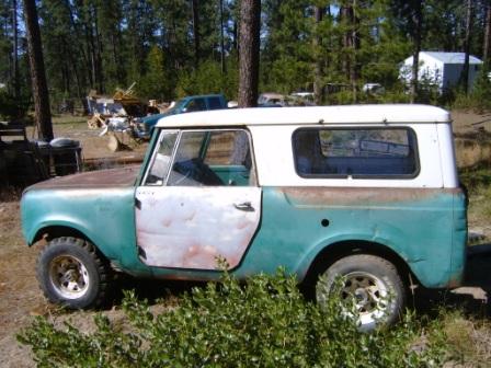

External pictures
Here are some of the outside.
Ray
  • Looking at a engine swap from a Ranger to a Scout

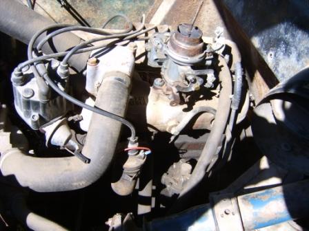

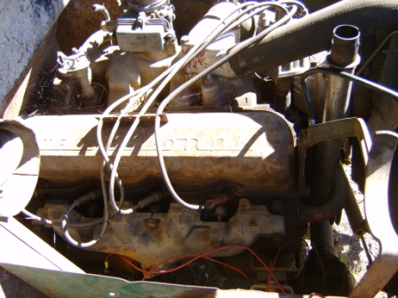

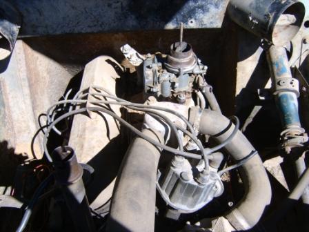

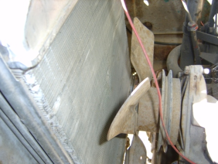

Pictures of the engine compartment
Here are some different angles of the engine bay.
Ray
