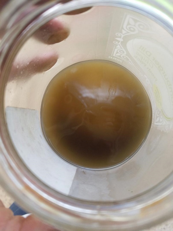

Recently I noticed a hesitation hitting passing gear and a fuel mileage drop. Decided to change the fuel filter and found all kinds of goodies.
Water, sand, misc debris, and what looked to be gas.

Looks to me like it did its job!
Yeah it did but it was so bad that it was dripping out of the front side of the filter going to the injectors also. How nothing got clogged I don't know.
Nasty! I haven't seen anything that nasty since the early 70s. Found some really filthy gas during the big gas rationing crisis. About all you could get was the crud from the bottom of their tanks.
That's the same color mine was coming out when I changed mine. Mine had a black/grey tint to it though. Fuel at the motor was clear so my filter was doing its job thank god. Next plans are to remove bed, remove fuel pump, clean tank, put new pump in, paint frame john deer green since bed will be off then reinstall everything. Someone said the gas tanks have baffles (walls) in them so cleaning it may be hard. Will try the magnet tricks. Sucks because I still have 3/4 of a tank.
