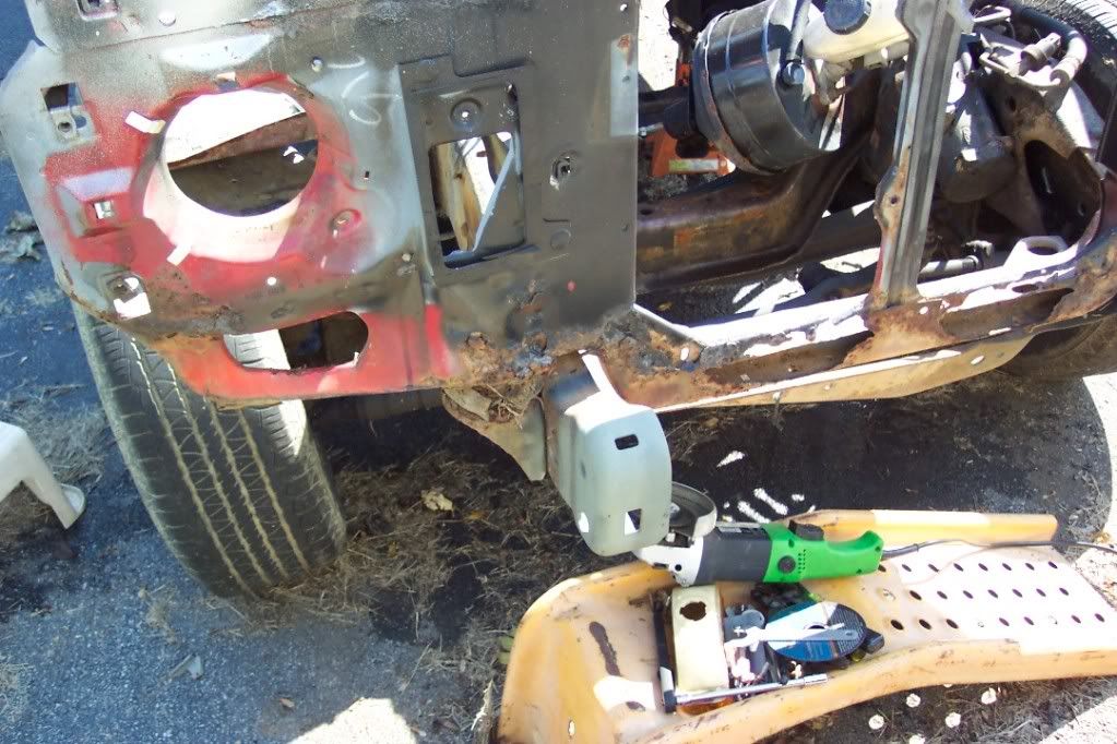

I also worked a little on the core support, I knew it was rusty, but not this bad.
Look at what I got
Look at what I got
Look at what I got
Look at what I got
Cut out the rusted parts
Look at what I got
Look at what I got
I also found a ouchy, I don't know if I'm going to replace the side panel or not, just depends on how I feel.
Look at what I got

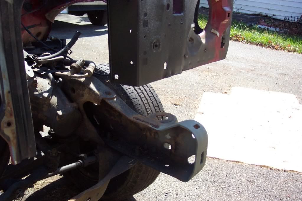

Lucky the frame isn't bent, and unlucky, I had cut the bottom or the core support off the 92 Explorer, I thought I could use it and graft them together, well that isn't going to work, so now I'm on the hunt for a new to me core support, and I would hate to go to Pull-A-Part and have to drill out 50 million spot welds trying to get a good one.

there is not really that many spot welds. get a $5 spot weld cutter from HF and you will be done in one day tops. I just did it on a b2 not even 2 weeks ago.
Well, I'm going to try a flog this dead horse back to life.
OK, here is a small update, I got a new to me, no rust rad support, pretty darn cheap at Pull-A-Parts, I don't have it welded in yet, I'm going to wait till have the engine in and some other mods that will require that it isn't in.
