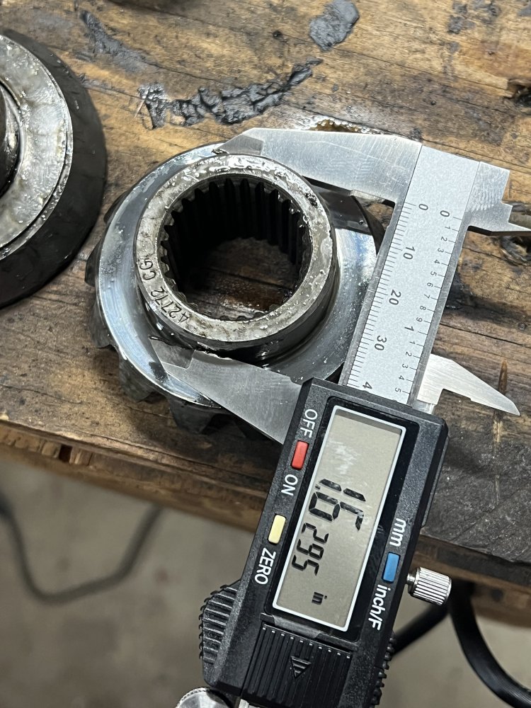

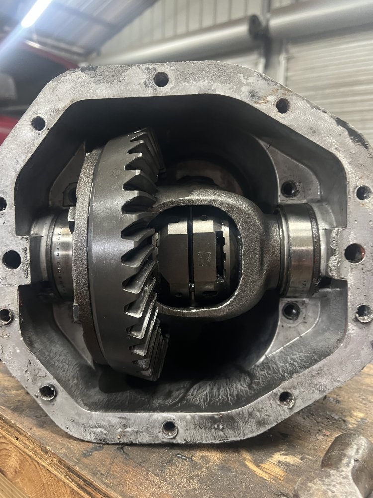

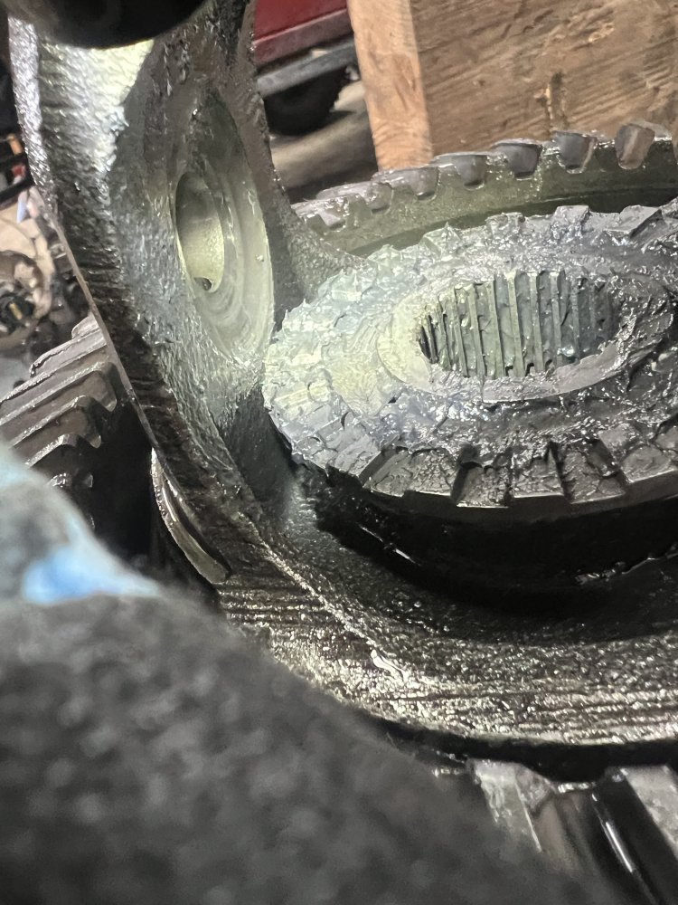

Trying to install a lockrite into my Dana 35ttb that already had 4.56s setup in it.

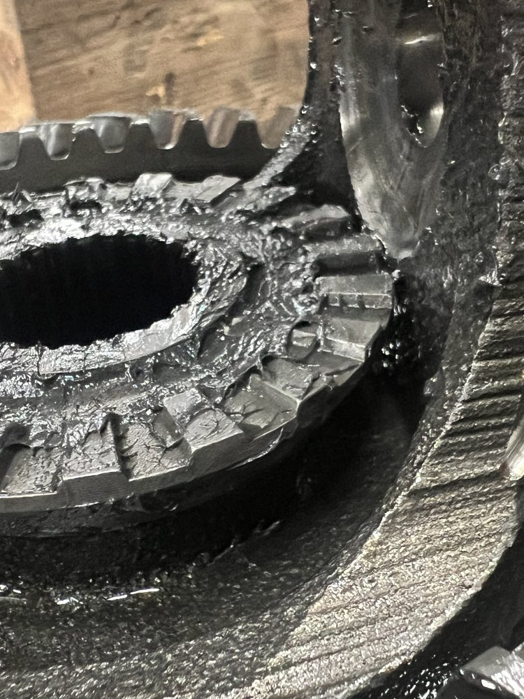

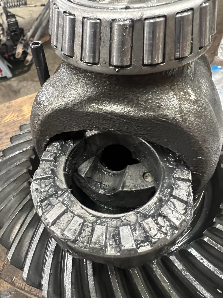

when I go to install the parts that replace the large spider gears, they fit in initially but do not sit all the way into their spots. It appears they are a tiny bit too wide and are hitting the inside of the case and not allowing them to seat all the way or spin. On top of that the two center sections barely fit inside the carrier at all. The clearance is so tight it will basically not go in without a gentle tap with a hammer.
Is it possible I have the wrong part#? The box is showing 2300-lr which is what I believe to be correct. However, I purchased this stuff used and it’s possible the guy had multiple lockrites and ended up putting the wrong one in the right box.

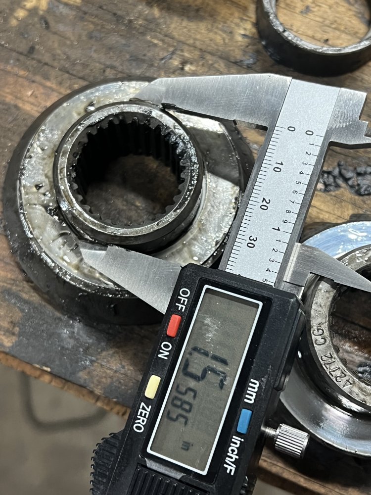

You are correct tho, it appears I have the parts of 2311 in a box labeled 2310. I bought this stuff used off a guy with what I thought had been a 1st gen explorer. The truck had long since been wrecked by the time I bought the gears and this locker off him. I’m wondering if long ago he bought 2311 on accident, then purchased 2310 and installed it in his truck. After that he tossed the 2311 bits back into the better of the two boxes which happened to have been the 2310 box.

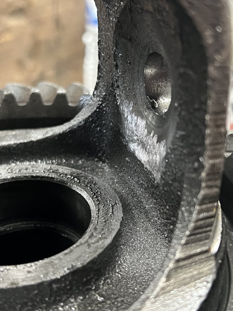

So long story short, I ordered a 2310 and it will be here tomorrow. I did jump the gun a bit and clearanced the case a hair before I realized the side gear hubs were the wrong size. I did so because I actually called Richmond gear and spoke to a tech guy. He said “it’s uncommon but has occurred where the factory case casting is just thiqquer than normal and requires a tad bit of clearance” I went ahead and did that then he called me back to ask when the hub sizing was, thus bringing me to the conclusion above.

I agree too wide to spin is the wrong part. That said, different manufacturer, but with the Aussie XD-13527, having to file the window in the carrier and install thinner thrust washers to have enough clearance is normal in TTB installs, per their instructions.
Just to finish this thread off, 2310-LR arrived today and installed easily after sanding down the OD of the side gears that fits into the carrier. It was just a hair too tight making the side gears unable to spin freely. It is installed now and I believe it to be working as it should.
