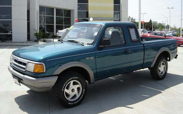

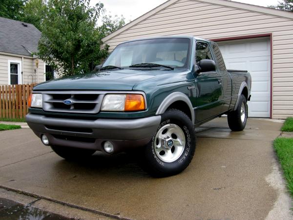

Best suggestion I have to "hide" them is to get a set of '95-'97 Ranger hub caps & lug nuts or '91-'94 STX/Explorer wheels. The hub caps on these fit around the hub with the end flush (or if you can't find those, some careful work with a Dremel or similar tool on any '98-'11 hub cap should produce a similar look).

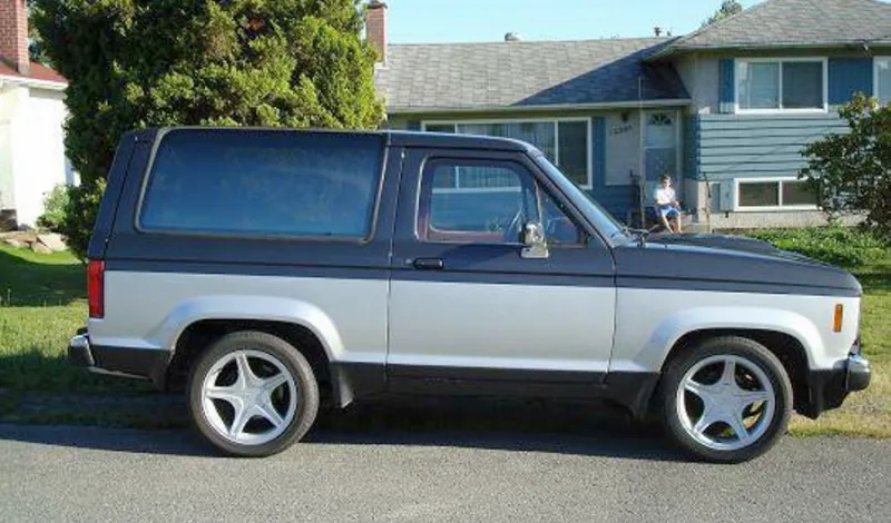

I was looking at this thing. It's obviously 2WD

2.)Can I buy the ground effects on the Bronco in the picture somewhere online? Or would I have to cut them off of a Bronco that already has them?

I also suspect that body kit might be a custom fiberglass project. It's not the highest resolution, but it looks like there's some Bondo work in front of the rear fender.
Bronco II XLS had bottom molding like that, I have never seen one in real life but I think it is fiberglass.
