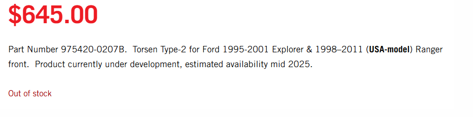

Torsen makes a geared LSD that fits, but only manufactures them in occasional batch runs so they are hard to get.

@pjtoledo gave you the info that I would give. @gw33gp runs that Torsen up front and could likely answer a question you might have about one. You might be able to pre order one... but I'm unsure of that.
This has been discussed here before... I'll do a little searching and see what I can find.
I see the link. missed it first time around. I thought he was trying to sell me something.

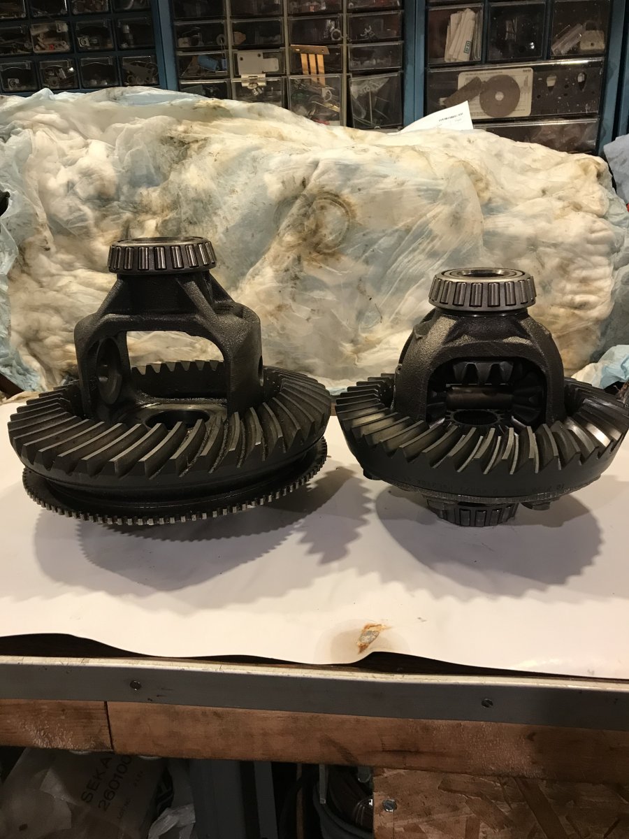

since you mentioned "extreme wheeling" with a 2002 front factory axle.....
the one on the left/bottom is a plain 'ol 8.8 with 28 splines. on the right/top is your front diff. cute 'lil thing ain't it?

If you are interested in the Torsen LSD, call or email them and ask that you be put on the list to contact when they are available. They are unsure that the time posted on the website will be met because of supply issues but will send out notifications as soon as they have them in stock.
